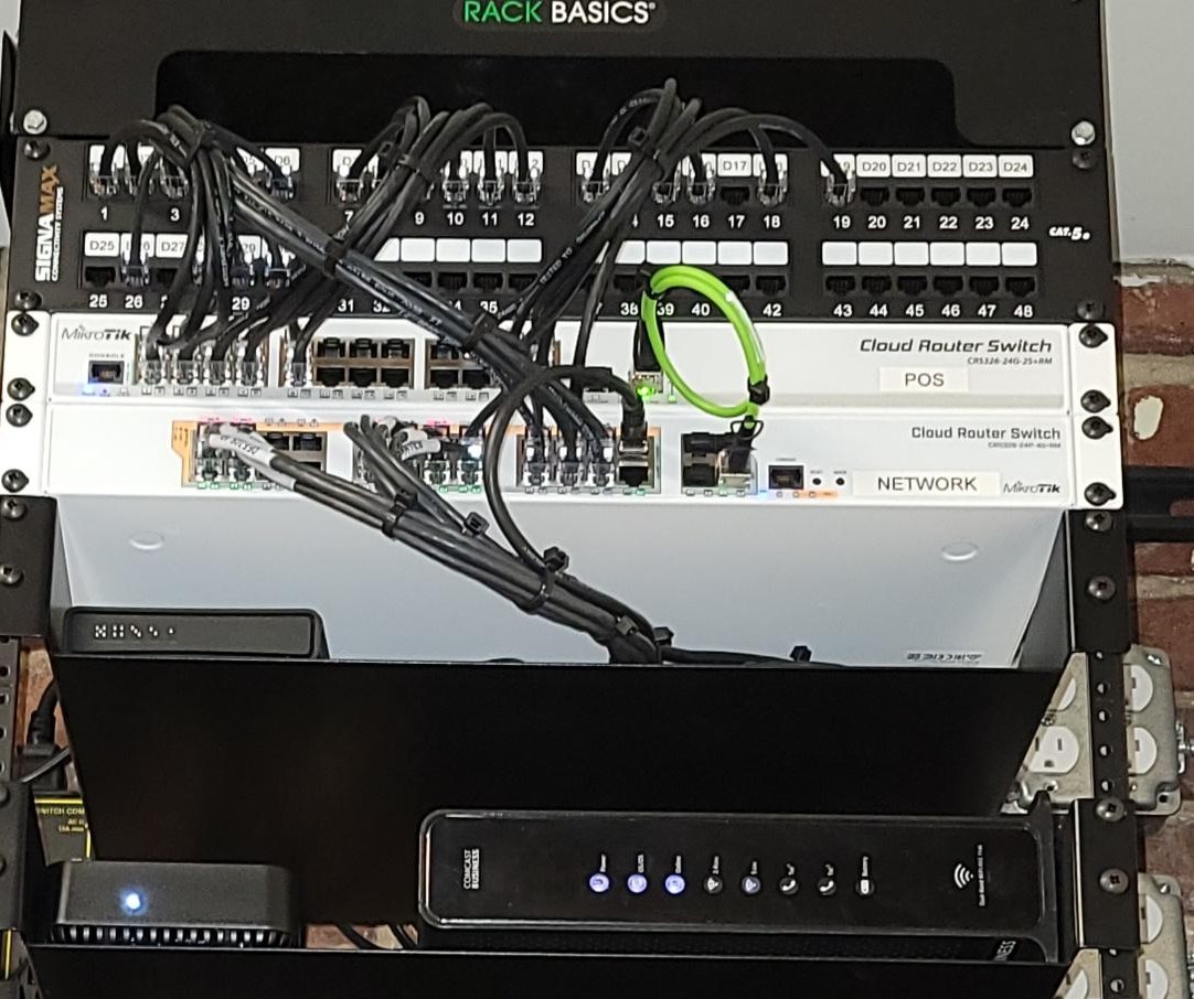

Point of Sales systems often need a wired device or 2. So having dedicated switch ports becomes a necessity. Throw in door access or phone systems or cameras… AND YOU NEED A SWITCH.
I have been burned by Mikrotik wireless too many times. So I choose another vendor for that…
But a Mikrotik hAP AC2 connected to a CRS328-24P+S-RM with a CRS326-24G-S-RM Has been an exceptional solution for a bunch of our bars and restaurants. Even have one of those resort type gyms running off that combo.
I would prefer a RB4011 or RB5009… But I can’t even get them over here in the US.
A few VLANs and SSIDs… We have systems that “do their thing” for years at a time, with ZERO SERVICE CALLS.

IT WAS SWEET!
Until all the Point of Sales devices and credit care readers couldn’t connect anymore…
:slight_smile:
Sounds like something you could easily show me with some beers and a hapax3.
Will let you know when mine arrives and perhaps we can skype or something LOL
