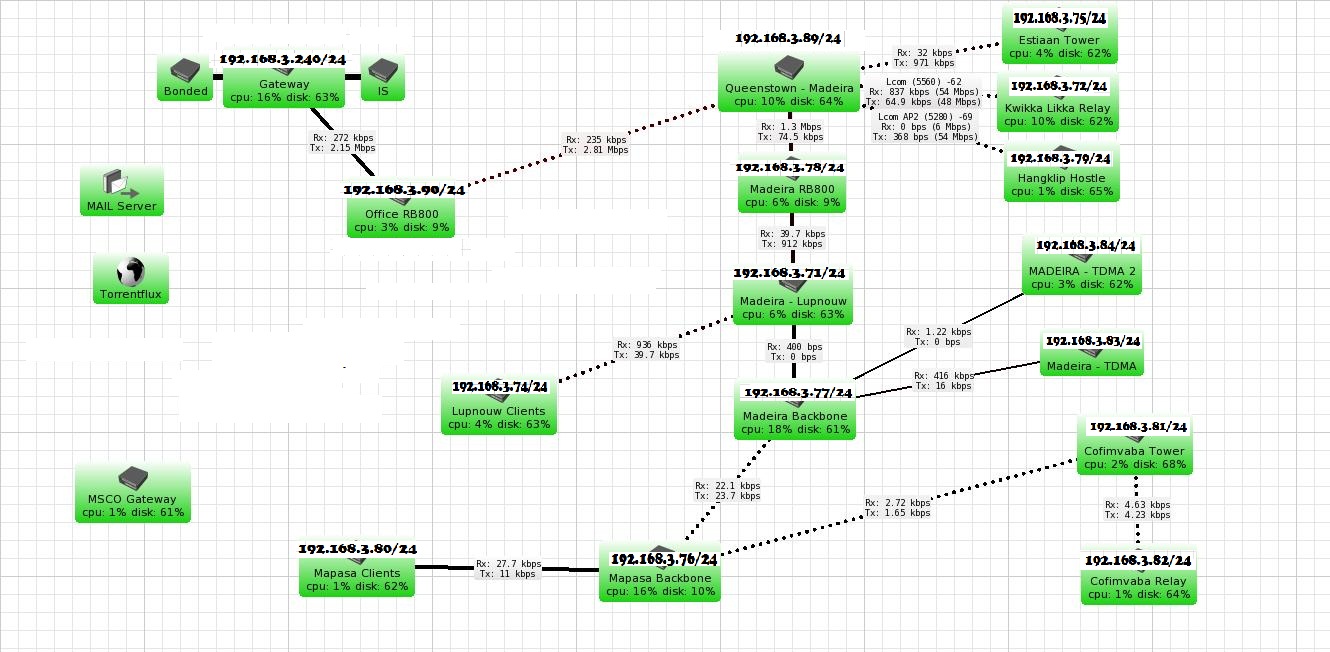

Ive got an Large Bridged network, with an single broadcast domain (192.168.3.0/24)
Ive got about 10 towers, and around 150 clients.with an average usage of around 10mbps.
all my clients connects to my towers using pppoe, and radiusmanager asigning private ip’s to each client.
Up to now all is working fine, but I am seeing an decreasing in available bandwidth between towers, as I add more towers.
Now I know I should be running an routed network, and I have tried twice to set it up, with no luck.
Ive got the following ip-list for a few of my towers, to setup OSPF on. But I cannot afford any downtime.

As soon as I add all these addresses and disable the bridges, I lock myself out of the network, and cause downtime. OSPF is then enabled.
If I setup OSPF correctly, how will my clients get an private IP to 0.0.0.0/0?
Attached is my network diagram. :smiley:
Create a vlan at each site, add a unique subnet to each vlan that can be aggregated (10.10.1.0/24,10.10.2.0/24 or whatever). Create an ospf backbone area at your core, then create a nssa area. Add the nssa to each site. Add the local subnet (10.10.x.0/24) to that area. Set identity on each sites router to its ip. Now the Vlans should be a routed network with ospf. Migrate each ap in turn to the vlan. This leaves the large bridged network in place to avoid down time. Once everything is migrated to the vlan, you can remove the bridges.
When you say create an vlan, what do you do with wireless links, do you create an tunnel?

I am not sure but the main object is not to lose network connectivity while changing over, AP’s you can use an CPE, PTP make sure you have Wlan ip address, plan your moves ,
(1) Sketch out each PTP router with /30 setting, ospf, dns, ip addresses,
(2) Ap’s as above with /24 different IP address and subnets for PPPoE,
(2) make out code for each router with these setting, you could run on each router these setting but maybe have them disabled=yes
(3) As you should have network connectivity if you use a different IP address and subnets for PPPoE use a CPE to login to AP, mac-telnet from AP to PTP and so on,
(4) Setup a test router with current setting and check change over proceedure,
(5) If the new configuration is setup on each router but disabled then it should be a matter of having for each router the original code used but this time “disabled=no” and code to delete bridge and disable any other routing setting used for old ip’s /24 addresses, the router should come back on if new setting are correctly setup.
Why not post config for one router (as usual remove any passwords, etc) and then maybe other users could suggest additional steps to follow for this.

default
set 1 change-tcp-mss=yes dns-server=192.168.3.240 local-address=Local name=
default-encryption only-one=default remote-address=Remote
use-compression=default use-encryption=yes use-ipv6=yes use-mpls=default
use-vj-compression=default
/queue type
set 0 kind=pfifo name=default pfifo-limit=50
set 1 kind=pfifo name=ethernet-default pfifo-limit=50
set 2 kind=sfq name=wireless-default sfq-allot=1514 sfq-perturb=5
set 3 kind=red name=synchronous-default red-avg-packet=1000 red-burst=20
red-limit=60 red-max-threshold=50 red-min-threshold=10
set 4 kind=sfq name=hotspot-default sfq-allot=1514 sfq-perturb=5
set 5 kind=none name=only-hardware-queue
set 6 kind=mq-pfifo mq-pfifo-limit=50 name=multi-queue-ethernet-default
set 7 kind=pfifo name=default-small pfifo-limit=10
/routing bgp instance
set default as=65530 client-to-client-reflection=yes disabled=no
ignore-as-path-len=no name=default out-filter=“” redistribute-connected=
no redistribute-ospf=no redistribute-other-bgp=no redistribute-rip=no
redistribute-static=no router-id=0.0.0.0 routing-table=“”
/routing ospf instance
set [ find default=yes ] disabled=no distribute-default=
if-installed-as-type-1 in-filter=ospf-in metric-bgp=auto
metric-connected=20 metric-default=1 metric-other-ospf=auto metric-rip=20
metric-static=20 name=default out-filter=ospf-out redistribute-bgp=no
redistribute-connected=as-type-1 redistribute-other-ospf=no
redistribute-rip=no redistribute-static=as-type-1 router-id=0.0.0.0
/routing ospf area
set [ find default=yes ] area-id=0.0.0.0 disabled=no instance=default name=
backbone type=default
/routing ospf-v3 instance
set [ find default=yes ] disabled=no distribute-default=never metric-bgp=auto
metric-static=20 name=default redistribute-bgp=no redistribute-connected=
no redistribute-other-ospf=no redistribute-rip=no redistribute-static=no
router-id=0.0.0.0
/routing ospf-v3 area
/snmp community
set [ find default=yes ] address=0.0.0.0/0 authentication-password=“”
authentication-protocol=MD5 encryption-password=“” encryption-protocol=
DES name=public read-access=yes security=none write-access=no
/system logging action
set 0 memory-lines=100 memory-stop-on-full=no name=memory target=memory
set 1 disk-file-count=2 disk-file-name=log disk-lines-per-file=100
disk-stop-on-full=no name=disk target=disk
set 2 name=echo remember=yes target=echo
set 3 bsd-syslog=no name=remote remote=:: remote-port=514 src-address=0.0.0.0
syslog-facility=daemon syslog-severity=auto target=remote
/user group
set read name=read policy=“local,telnet,ssh,reboot,read,test,winbox,password,w
eb,sniff,sensitive,api,!ftp,!write,!policy” skin=default
set write name=write policy=“local,telnet,ssh,reboot,read,write,test,winbox,pa
ssword,web,sniff,sensitive,api,!ftp,!policy” skin=default
set full name=full policy=“local,telnet,ssh,ftp,reboot,read,write,policy,test,
winbox,password,web,sniff,sensitive,api” skin=default
add bridge=bridge1 disabled=no edge=auto external-fdb=auto horizon=none
interface=ether1 path-cost=10 point-to-point=auto priority=0x80
interface=wlan1 path-cost=10 point-to-point=auto priority=0x80
add bridge=“Clients Bridge” disabled=no edge=auto external-fdb=auto horizon=
none interface=Clients path-cost=10 point-to-point=auto priority=0x80
interface=ether2 path-cost=10 point-to-point=auto priority=0x80
/interface bridge settings
set use-ip-firewall=no use-ip-firewall-for-pppoe=no use-ip-firewall-for-vlan=
no
/interface l2tp-server server
set authentication=pap,chap,mschap1,mschap2 default-profile=
default-encryption enabled=no max-mru=1460 max-mtu=1460 mrru=disabled
/interface ovpn-server server
set auth=sha1,md5 certificate=none cipher=blowfish128,aes128 default-profile=
default enabled=no keepalive-timeout=60 mac-address=FE:A7:4D:15:79:A6
max-mtu=1500 mode=ip netmask=24 port=1194 require-client-certificate=no
/interface pppoe-server server
add authentication=pap,chap,mschap1,mschap2 default-profile=default disabled=
no interface=“Clients Bridge” keepalive-timeout=10 max-mru=1480 max-mtu=
1480 max-sessions=0 mrru=disabled one-session-per-host=yes service-name=
service1
/interface pptp-server server
set authentication=mschap1,mschap2 default-profile=default-encryption
enabled=no keepalive-timeout=30 max-mru=1460 max-mtu=1460 mrru=disabled
/interface sstp-server server
set authentication=pap,chap,mschap1,mschap2 certificate=none default-profile=
default enabled=no keepalive-timeout=60 max-mru=1500 max-mtu=1500 mrru=
disabled port=443 verify-client-certificate=no
/interface wireless access-list
add ap-tx-limit=0 authentication=yes client-tx-limit=0 disabled=no
forwarding=yes interface=all mac-address=00:21:A4:31:2E:B8
management-protection-key=“” private-algo=none private-key=“”
private-pre-shared-key=“” signal-range=-120..120
forwarding=yes interface=all mac-address=00:0C:42:9F:FB:2C
forwarding=yes interface=all mac-address=00:0C:42:8D:FB:49
forwarding=yes interface=all mac-address=00:0C:42:6C:0E:68
forwarding=yes interface=all mac-address=00:21:A4:31:2E:97
forwarding=yes interface=all mac-address=00:0C:42:8E:42:13
/interface wireless align
set active-mode=yes audio-max=-20 audio-min=-100 audio-monitor=
00:00:00:00:00:00 filter-mac=00:00:00:00:00:00 frame-size=300
frames-per-second=25 receive-all=no ssid-all=no
/interface wireless sniffer
set channel-time=200ms file-limit=10 file-name=“” memory-limit=10
multiple-channels=no only-headers=no receive-errors=no streaming-enabled=
no streaming-max-rate=0 streaming-server=0.0.0.0
/interface wireless snooper
set channel-time=200ms multiple-channels=yes receive-errors=no
/ip accounting
set account-local-traffic=no enabled=no threshold=256
/ip accounting web-access
set accessible-via-web=no address=0.0.0.0/0
add address=192.168.3.89/24 disabled=no interface=bridge1 network=192.168.3.0
add address=192.168.4.130/30 disabled=no interface=wlan1 network=
192.168.4.128
add address=192.168.4.3/29 disabled=no interface=ether1 network=192.168.4.0
/ip dhcp-server config
set store-leases-disk=5m
set allow-remote-requests=no cache-max-ttl=1w cache-size=2048KiB
max-udp-packet-size=512 servers=“”
set enabled=yes generic-timeout=10m icmp-timeout=10s tcp-close-timeout=10s
tcp-close-wait-timeout=10s tcp-established-timeout=1d
tcp-fin-wait-timeout=10s tcp-last-ack-timeout=10s
tcp-syn-received-timeout=5s tcp-syn-sent-timeout=5s tcp-syncookie=no
tcp-time-wait-timeout=10s udp-stream-timeout=3m udp-timeout=10s
add action=masquerade chain=srcnat disabled=no
/ip firewall service-port
set ftp disabled=no ports=21
set tftp disabled=no ports=69
set irc disabled=no ports=6667
set h323 disabled=no
set sip disabled=no ports=5060,5061 sip-direct-media=yes
set pptp disabled=no
/ip hotspot service-port
/ip neighbor discovery
set wlan1 disabled=yes
set ether1 disabled=no
set ether2 disabled=no
set ether3 disabled=no
set bridge1 disabled=no
set Clients disabled=no
set “Clients Bridge” disabled=no
/ip proxy
set always-from-cache=no cache-administrator=webmaster cache-hit-dscp=4
cache-on-disk=no enabled=no max-cache-size=none max-client-connections=
600 max-fresh-time=3d max-server-connections=600 parent-proxy=0.0.0.0
parent-proxy-port=0 port=8080 serialize-connections=no src-address=
0.0.0.0
add disabled=no distance=2 dst-address=0.0.0.0/0 gateway=192.168.3.240 scope=
30 target-scope=10
add disabled=no distance=1 dst-address=10.10.15.0/24 gateway=192.168.3.78
scope=30 target-scope=10
add disabled=yes distance=1 dst-address=192.168.3.240/32 gateway=
192.168.10.90 scope=30 target-scope=10
add disabled=no distance=1 dst-address=192.168.4.1/32 gateway=192.168.4.130
add disabled=no distance=1 dst-address=192.168.4.16/29 gateway=192.168.4.4
/ip service
set telnet address=“” disabled=no port=23
set ftp address=“” disabled=no port=21
set www address=“” disabled=no port=80
set ssh address=“” disabled=no port=22
set www-ssl address=“” certificate=none disabled=yes port=443
set api address=“” disabled=no port=8728
set winbox address=“” disabled=no port=8291
/ip smb
set allow-guests=yes comment=MikrotikSMB domain=MSHOME enabled=no interfaces=
all
/ip smb shares
set [ find default=yes ] comment=“default share” directory=/pub disabled=no
max-sessions=10 name=pub
/ip smb users
set [ find default=yes ] disabled=no name=guest password=“” read-only=yes
/ip socks
set connection-idle-timeout=2m enabled=no max-connections=200 port=1080
/ip traffic-flow
set active-flow-timeout=30m cache-entries=4k enabled=no
inactive-flow-timeout=15s interfaces=all
/ip upnp
set allow-disable-external-interface=yes enabled=no show-dummy-rule=yes
/ipv6 nd
set [ find default=yes ] advertise-dns=no advertise-mac-address=yes disabled=
no hop-limit=unspecified interface=all managed-address-configuration=no
mtu=unspecified other-configuration=no ra-delay=3s ra-interval=3m20s-10m
ra-lifetime=30m reachable-time=unspecified retransmit-interval=
unspecified
/ipv6 nd prefix default
set autonomous=yes preferred-lifetime=1w valid-lifetime=4w2d
/mpls
set dynamic-label-range=16-1048575 propagate-ttl=yes
/mpls interface
set [ find default=yes ] disabled=no interface=all mpls-mtu=1508
/mpls ldp
set distribute-for-default-route=no enabled=no hop-limit=255 loop-detect=no
lsr-id=0.0.0.0 path-vector-limit=255 transport-address=0.0.0.0
use-explicit-null=no
/port firmware
set directory=firmware
/ppp aaa
set accounting=yes interim-update=0s use-radius=no
/queue interface
set wlan1 queue=only-hardware-queue
set ether1 queue=ethernet-default
set ether2 queue=ethernet-default
set ether3 queue=ethernet-default
set Clients queue=wireless-default
/radius
add accounting-backup=no accounting-port=1813 address=192.168.3.251
authentication-port=1812 called-id=“” disabled=no domain=“” realm=“”
secret=Passw0rd service=ppp,login,hotspot,wireless,dhcp timeout=2s
/radius incoming
set accept=yes port=1700
/routing bfd interface
set [ find default=yes ] disabled=no interface=all interval=0.2s min-rx=0.2s
multiplier=5
/routing igmp-proxy
set query-interval=2m5s query-response-interval=10s quick-leave=no
/routing mme
set bidirectional-timeout=2 gateway-class=none gateway-keepalive=1m
gateway-selection=no-gateway origination-interval=5s preferred-gateway=
0.0.0.0 timeout=1m ttl=50
/routing ospf network
add area=backbone disabled=no network=192.168.4.128/30
add area=backbone disabled=no network=192.168.4.0/29
add area=backbone disabled=no network=192.168.4.16/29
add area=backbone disabled=no network=192.168.4.132/30
/routing pim
set switch-to-spt=yes switch-to-spt-bytes=0 switch-to-spt-interval=1m40s
/routing rip
set distribute-default=never garbage-timer=2m metric-bgp=1 metric-connected=1
metric-default=1 metric-ospf=1 metric-static=1 redistribute-bgp=no
redistribute-connected=no redistribute-ospf=no redistribute-static=no
routing-table=main timeout-timer=3m update-timer=30s
/routing rip interface
add authentication=none authentication-key=“” disabled=no in-prefix-list=“”
interface=wlan1 key-chain=“” out-prefix-list=“” passive=no receive=v1-2
send=v1-2
/routing rip network
add disabled=no network=192.168.3.0/24
/routing ripng
/snmp
set contact=“” enabled=yes engine-id=“” location=“” trap-community=public
trap-generators=start-trap trap-target=“” trap-version=2
/system clock
set time-zone-name=Africa/Johannesburg
/system clock manual
set dst-delta=+00:00 dst-end=“jan/01/1970 00:00:00” dst-start=
“jan/01/1970 00:00:00” time-zone=+00:00
/system console
set [ find port=serial0 ] disabled=no port=serial0 term=vt102
