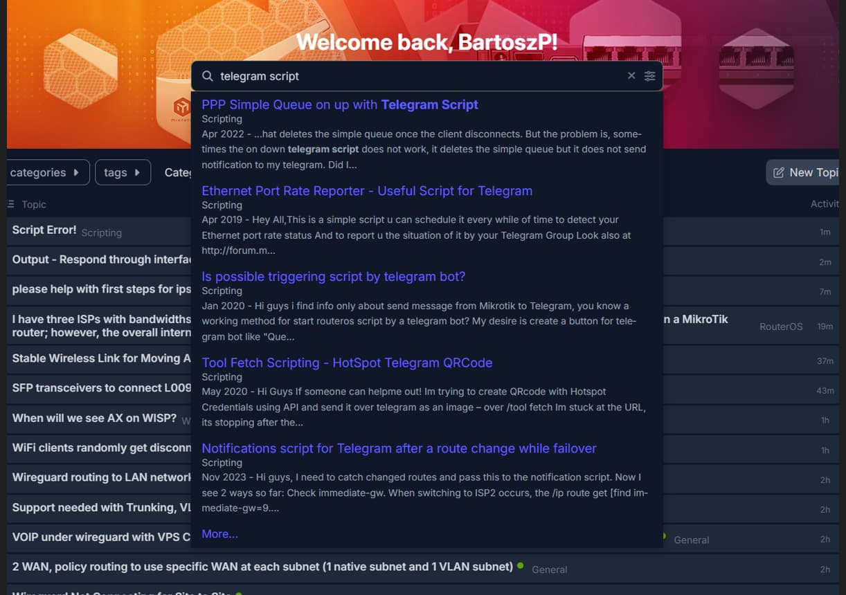

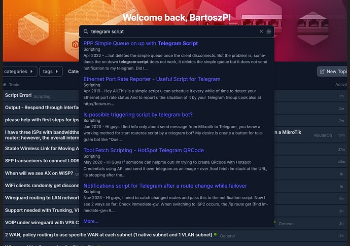

For these who are too laz. not fluent in using advanced tools:
