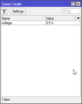

ROS ver.7.1rc6
/system health print
NAME VALUE TYPE
0 voltage 0.5 V
** Temperature not showing up!
** Bad Voltage Reading !
Terminal or in WinBox (See Attachment)

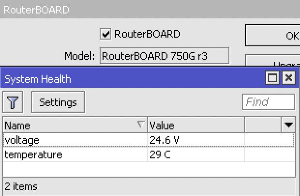

running 6.49.1 on my attic, approx 20C in that room …
Thanks a lot for that information, are really very very good temps. So, I will retire an old RB450G that stay at 77°C and reboots constantly with 35°C on my attic.
I looked up this device and I believe that is a really good replacement but only I needed make sure about the temps of this device.

Thanks @ConnyMercier
In the “ROS ver.7.1rc6” is software cosmetic bug, information is forwarded to person in charge.
@elans,
ROS ver.7.1rc7 still has the “cosmetic” bug
