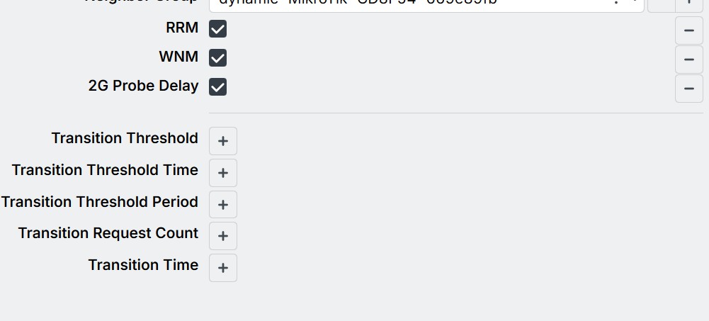

Thanks, this is very interesting.
I currently have FT and FT-over-DS enabled, but I haven't really optimized client steering yet.
Looking at my registration table, most clients are around -40 to -60 dBm, but I occasionally see clients remaining associated at -70 to -80 dBm, sometimes even around -85 dBm. Some of these clients also fall to very low PHY rates.
This makes me suspect that sticky clients may be contributing to airtime usage and latency.
You mentioned that enabling RRM/WNM and setting the transition threshold to -73 made a significant difference.
Could you please share your /interface wifi steering configuration, or the relevant CAPsMAN settings?
Also:
  • What beharvior did you see before enabling steering?
  • Did it specifically improve latency, or mainly roaming?
  • How did you decide on the -73 dBm threshold?
  • Do clients below -73 get disconnected, or are they only encouraged to roam?
  • Have you seen any compatibility problems with older Wifi clients after enabling RRM/WNM?
I would like to test this carefully bafore applying it to the production network.

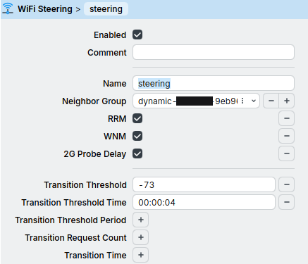

The threshold of -73 and why, well generally since i have only 3 access points in my house, i want to switch off of one access point to another as soon as my signal drops off even a little bit, 60 dBm is good signal, 40 is very good/close to the AP and in my cases i get around 20-25dBm when i have my phone ontop or very close to the AP. So by having good signal strength you usually have good speed and latency, latency can vary of course (due to the number of walls, thickness of walls, how far the AP's are, what bands you use, density of the deployment etc etc...)
In my case by setting the threshold itself it helped my roaming to be more consistant and i have more consistantly-good experience using my wifi. Does it improve latency? Well, i wouldn't say it improves latency exactly as in lower the number, but i would say it makes it more usable and predictable and more consistant at working how you want it, I also recommend lowering the number if you have a higher density of APs or upping it if its a lower density, i personally recommend the range from -70dBm and -75dBm. So i chose the middle ground for it which was -73dBm.
WNM is a 802.11v standard which improves the handoff process from one to another AP, basically makes your roaming better and smoother, smoothing off the "downtime" between transfers and it eliminated sticky clients for me, basically it works in a way where the current AP that you're connected to suggests to your devices that are connected to it "hey you're getting away from me and the signal is weak, i have this neighbor, connect to him he has better signal integrity and strength to you, bye." (To be more professional it also cuts down the handoff time between access points to ridiculously low times, we are talking double digit mili-seconds)
RRM if i understood it correctly, its the protocol that actually allows the AP itself to store a list of neighbor AP's and their bssid's and suggest them to devices it basically works hand in hand with WNM.
So for compatibility, i personally never had any issues, theres like 5 laptops (3 out of 5 have intel wireless adapters, ranging from ax210 to ax211 and a be200), an older TV and a whole lot of phones, some samsung A14s, some A16s and an s21. I in particular never had any issues with compatibilty, everything just worked for me ever since i enabled it, phones roam without any issues and my signal almost never drops past 2 bars for a brief second. A quick google told me that any phones/pagers (hospital pagers) that are older than 2016-17 shouldn't have any issues with the wifi.
If this is a very serious corporate deployment where you have a lot of devices that absolutely must have a connection and must work seemlesly and don't have much downtime to work with, I cant guarantee, but i think enabling these options you SHOULDN'T have any issues if your devices that are connecting to the wifi are relatively new-ish (as i said past 2016-17.).

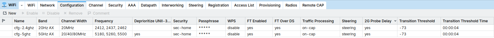

I have done my due diligence and checked out what i have setup as my wifi settings, so i screenshotted you my configs and my ping (AP to other device on the network, network path [laptop on wifi -> cAP ax -> rb5009Upr -> PC])

Thanks a lot for the detailed explanation and screenshots. They helped me understand your setup much better.
I'm going to test your steering settings on one AP first, especially RRM/WNM with the -73 dBm / 4s transition threshold, before applying anything more widely.

Connect Priority 0 / 1 is configured in CAPsMAN and is used by all cAPs (4).
If I disable it, devices using WPA3 have trouble roaming and stay connected to one cAP even when the signal is weak.
As for Steering, I enabled RRM, WNM, and 2G probe delay while keeping all other settings at default.
After a few months of use, I can say that roaming works very well, in both WPA2 and WPA3, and VoIP calls are always seamless even during roaming.
