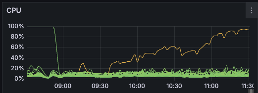

High CPU usage on single core (Supermicro Server, ROS 7.18.2) - likely SNAT issue
Hi everyone,
I’m running RouterOS 7.18.2 stable on a beefy Supermicro Super Server x86_64 with 56 cores.
My setup handles decent traffic (max inbound 1.22 Gb/s, outbound 665Mb/s), but I’m facing a weird CPU issue.
While my overall CPU usage stays around 8-11%, one core keeps hitting 100%.
After running the profiler, it points to firewall usage. Interestingly, even with filter rules disabled, the problem persists, so I suspect it’s SNAT related.
A reboot temporarily fixes it (CPU drops to normal), but over time it creeps back up to the same high values on that single core.

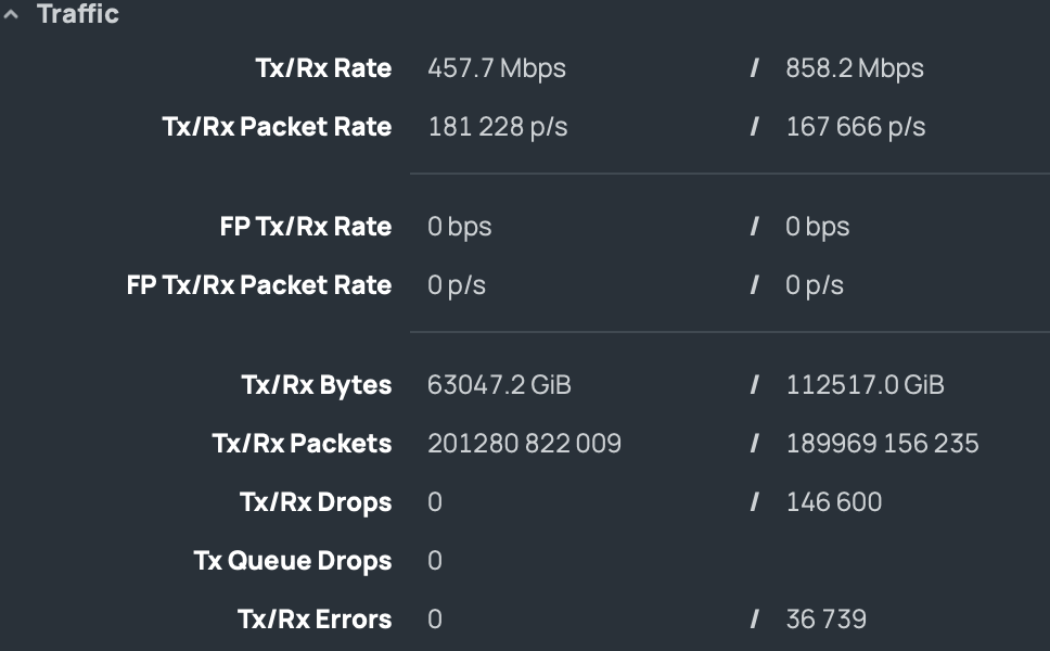

I don’t see many packet drops or errors relative to the overall traffic, and they are not increasing every minute.
