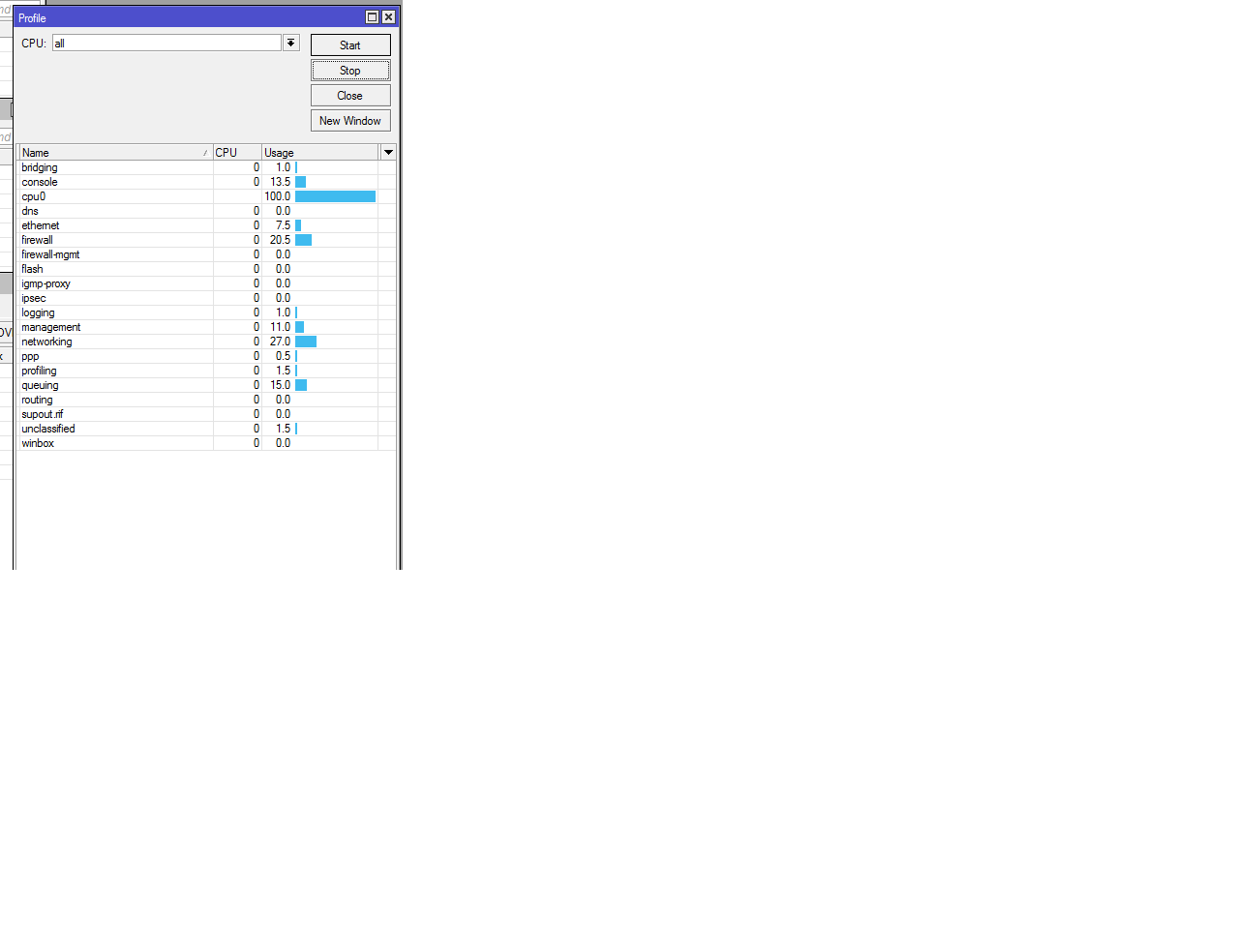

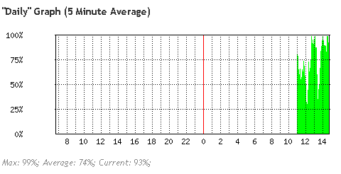

High CPU usage.
Help to deal with the problem of high load (up to 100%) of the processor on the CRS112-8G-4S.
There are up to 10 pppoe customers.

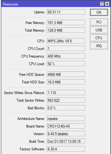

Even though the CRS112-8G-4S can be configured to be a router and firewall, it is not well suited for it. I think you’ll find the problem you have with the high load on the CPU is because the CPU in the CRS112-8G-4S is simply not powerful enough for queues and firewall rules. You would have better results if the routing, queues and firewalls were done by a dedicated router, and the switch was used only for switching.

Sorry, but this device is not meant to handle any tunneling and the CPU load you are experiencing is normal.
The CRS112-8G-4S is a routing capable switch, where the routing function is mainly for management purposes.
The cheapest MT device that would handle some tunneling is the RB750Gr3 ie. HEX
I regularly see CRS112’s hitting 100% on the CPU just from an SNMP call. I even see my one at home doing 80% just from viewing it in Winbox. Others have pointed out optimisations for you but you should probably invest and replace the device with either an RB2011 or RB3011.
