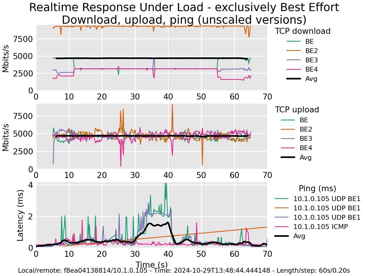

What I’m experiencing is high latency between clients and Ceph OSDs routed through CHR ( spans from 10ms to 50ms ), even though ping times and transfer tests are good:
  • pings (from client network to Ceph network) take about 0.25ms
  • running iperf3 I’m able to saturate the NICs ( 40Gbit bond LACP ) and CHR CPU usage stays within 15%
Unfortunately during a Flent test, I observed significant UDP packet loss which in case of TCP packets would cause more issues of course (attached image).
