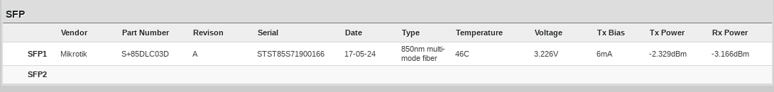

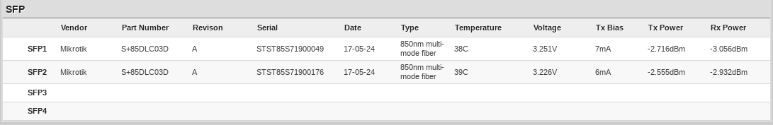

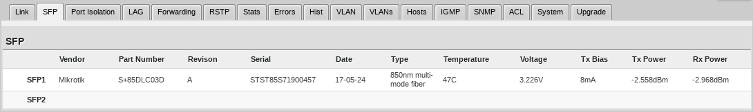

The images bellow show the SFP status of each switch.

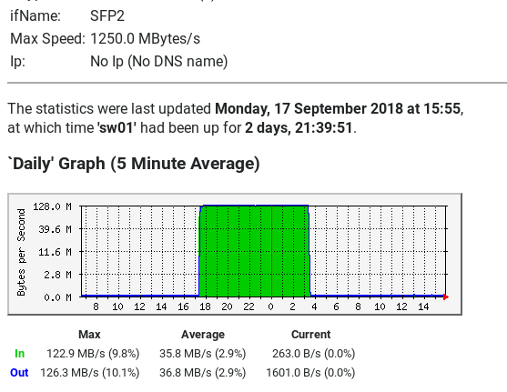

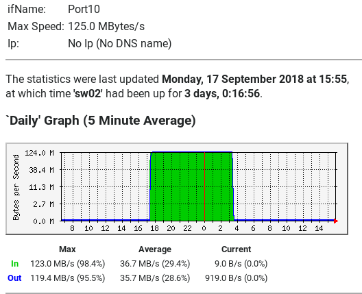

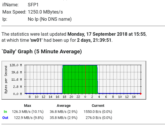

The bulk of errors were at sw01. The other two switches got some errors - but not much. Below we can see four rounds of iperf - two with sw01 running SwOS 2.8 and two running RoS 6.43. I run one iperf session at banda01 and another at banda02.
Sw02 and Sw03 are connected through 10Gb fiber, at Sw01. All tests cross the switches.

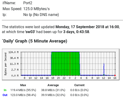

I didn’t talked to them. Yet. Need to get some free time to do it. For now, it is working with RoS. Not what I wanted, but good enough. With two CSS326 and one CRS328 (running RoS), I got about 97% of link usage, on the 1Gb port - up and down. Sustained iperf test, running for 10 hours. With this setup I did get some errors, but nothing that bothers me. With the CRS328 running SwOS the situation was terrible: I couldn’t get past 70% of link usage.
SFP1 on CRS328 (SW01)
SFP2 on CRS328 (SW01)
SFP1 on CSS326 (SW02)
SFP1 on CSS326 (SW03)
All SFP ports are configured as trunk.

Just realised it works with CRS328 in ROS talking to CSS326 in SwOS that will be good enough for me.
Like the rrdtool graphs, what are you using mrtg?
Yes, MRTG
