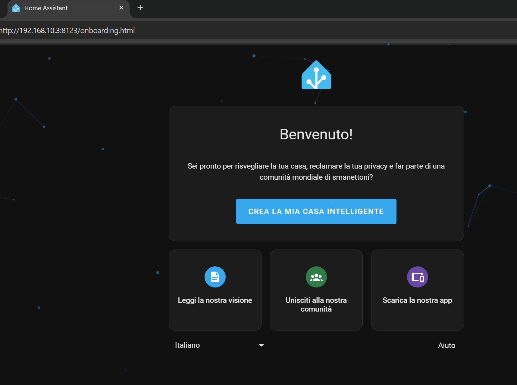

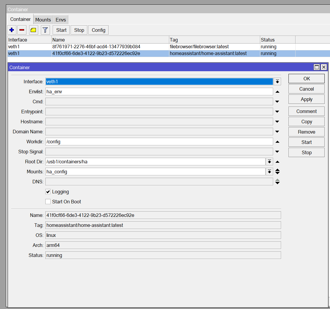

Finally make it work… :smiley:
a) Reset docker settings
b) docker pull homeassistant/home-assistant:latest@sha256:17d159928122e6f374bd39b0e75904522bc7d7c2a64e88b248948734e4c4d444 on my host machine
c) docker save -o ha_arm64.tar
d) Upload it to router
e) /container/add file=“usb1/img/ha.tar” interface=“veth1” envlist=“envha” cmd=“python3 -m homeassistant --config /config” hostname=“homeassistant” workdir=“/config” root-dir=“usb1/containers/homeassistant” mounts=“homeassistant” logging=yes
Now it works and I can access it.

It is not possible to pull the latest image or even stable image of homeassistant for arm64 on Mikrotik RB5009, because the size of image is more then 1.5GB, but the storage on RB5009 is only 1GB,
you must change your settings in container to use usb disk for pulling-downloading images:
container/config/set tmpdir=usb1/pull
Best regards!
