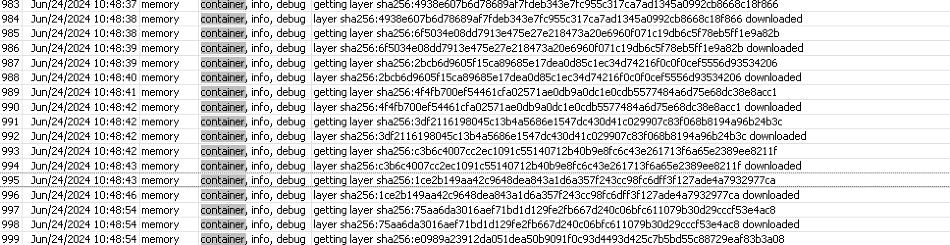

When I’m pulling the image it does shows log records

The last message in the log before container status turns to “stop” is
getting layer sha256:aa900376fa4645b30a0d731f2962ade576b143016fc7e8b4d4f12bbd34c30fca
In all other layers such record is followed by downloaded record. But not this one.
Previous layers are like this
getting layer sha256:e0989a23912da051dea50b9091f0c93d4493d425c7b5bd55c88729eaf83b3a08
layer sha256:e0989a23912da051dea50b9091f0c93d4493d425c7b5bd55c88729eaf83b3a08 downloaded

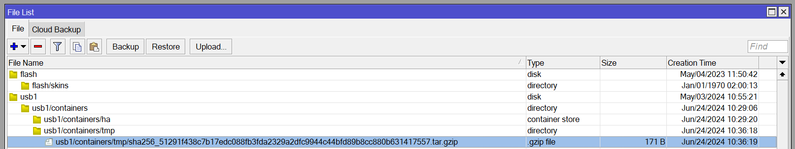

I’ve had the same problem for months, I’ve never been able to figure out where the problem was.
I tried to format the USB disk also changing the filesystem but nothing to do, it always stops at the same point:
The file download always stops at 171B
I don’t know if it’s a ROS bug…

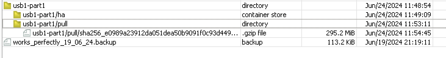

I’m trying to pull stable image.
Errors a totally random every time.
Some times it pulls arch and os and some times it is not.
I was trying all formats of the flash. With and without MBR.
What is consistent is it is always stuck on this layer.
From it’s size I can see it is that one
40.  RUN |1 QEMU_CPU= /bin/ash -o   295.15 MB
