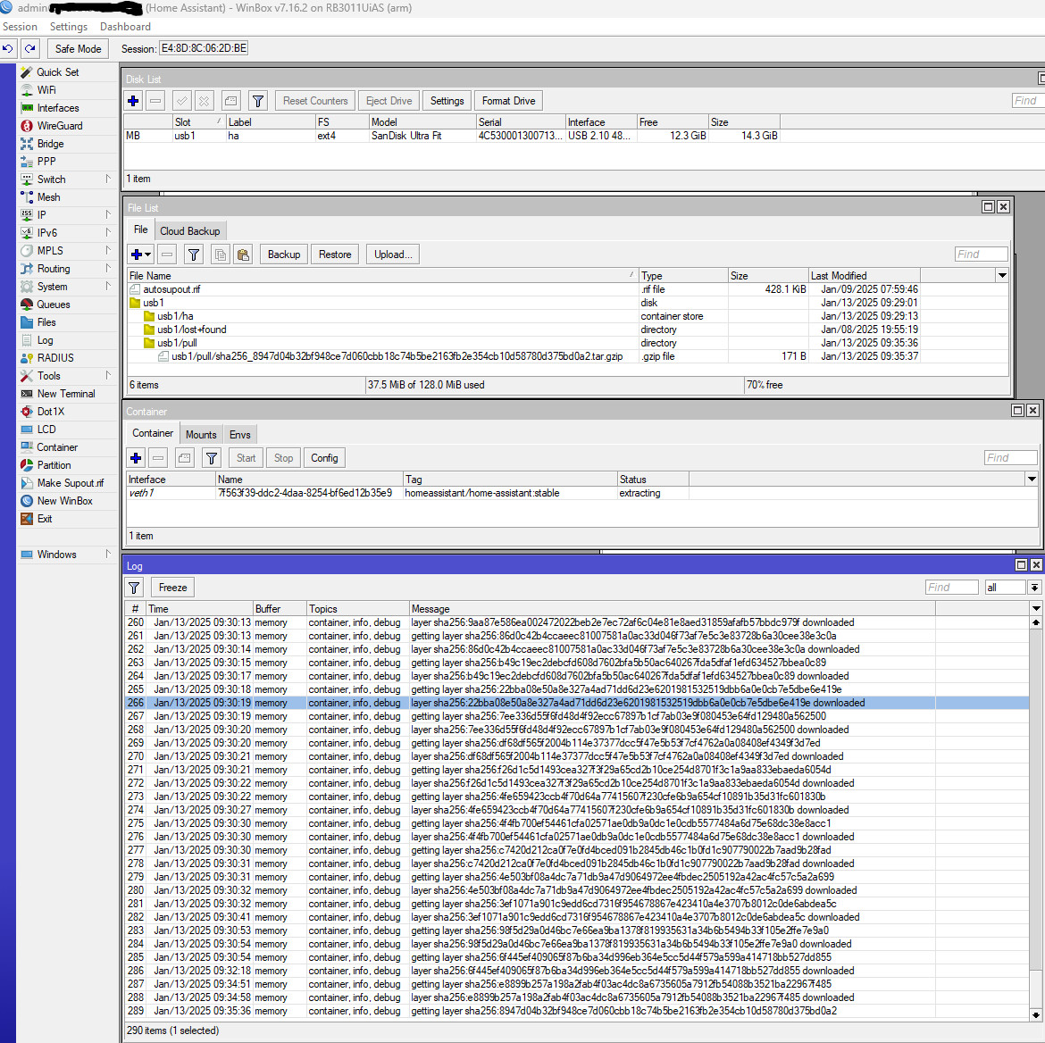

HW used is RB3011 with ROS 16.2, Sandisk 16GB USB3 stick.
Basically I have followed the guide at
https://help.mikrotik.com/docs/spaces/ROS/pages/204341276/Container+-+HomeAssistant
I start extracting the container using the command
/container/add remote-image=homeassistant/home-assistant:stable interface=veth1 root-dir=/usb1/ha mounts=ha_config envlist=ha_env logging=yes
and I can see the progress of downloading each .tar.gzip file in usb1/pull. After download of each archive CPU rises for a period of time, indicating extraction of archives is performed, but only the almighty Lord above knows where the extracted files are placed..
I have repeated the process quite a few times now, and often the process stops with one small archive (171 bytes) in /usb1/pull and status stuck at “extracting” like this:
Occasionally the extraction process appears to have completed with container status “Stopped”.
However it is not possible to start the container, simply nothing happens, no error message, no log entry.
Root dir for the container is set to /usb1/ha, am I supposed to have files stored there? It is always empty.
Can anyone please shed some light on this?
Will I be better off trying to download and extract the container manually, if possible?
Where do I go to find it?

# 2025-01-13 09:29:23 by RouterOS 7.16.2
# software id = ****-****
# model = RB3011UiAS
# serial number = ************
/container mounts
add dst=/config name=ha_config src=/usb1/ha_config
/disk
set usb1 media-interface=none media-sharing=no
add name=bridge-ha
/interface veth
add address=172.19.0.2/24 gateway=172.16.0.1 gateway6="" name=veth1
/port
set 0 name=serial0
/container
add envlist=ha_env interface=veth1 logging=yes mounts=ha_config root-dir=/usb1/ha
/container config
set ram-high=800.0MiB registry-url=https://registry-1.docker.io tmpdir=/usb1/pull
/container envs
add key=TZ name=ha_env value=Europe/Oslo
add bridge=bridge-ha interface=veth1
add address=192.168.0.200/24 interface=ether10 network=192.168.0.0
add address=172.19.0.1/24 interface=bridge-ha network=172.19.0.0
set allow-remote-requests=yes servers=192.168.0.1
add action=dst-nat chain=dstnat dst-address=192.168.0.200 dst-port=8123 protocol=tcp to-addresses=172.19.0.2
add disabled=no dst-address=0.0.0.0/0 gateway=192.168.0.1 routing-table=main suppress-hw-offload=no
/system clock
set time-zone-name=Europe/Oslo
/system identity
set name="Home Assistant"
/system logging
add topics=container,debug
And this is the command with which I try to create the container:
Any help would be highly appreciated, as I am completely stuck :frowning:

Changed paths as per your suggestion:
[admin@Home Assistant] /container/config> pr
      ram-high: 800.0MiB
  registry-url: https://registry-1.docker.io
        tmpdir: usb1/pull
      username:
      password:
     layer-dir: usb1/layers
However that did not change the outcome, it stopped after downloading the 171 bytes file, like it normally does.

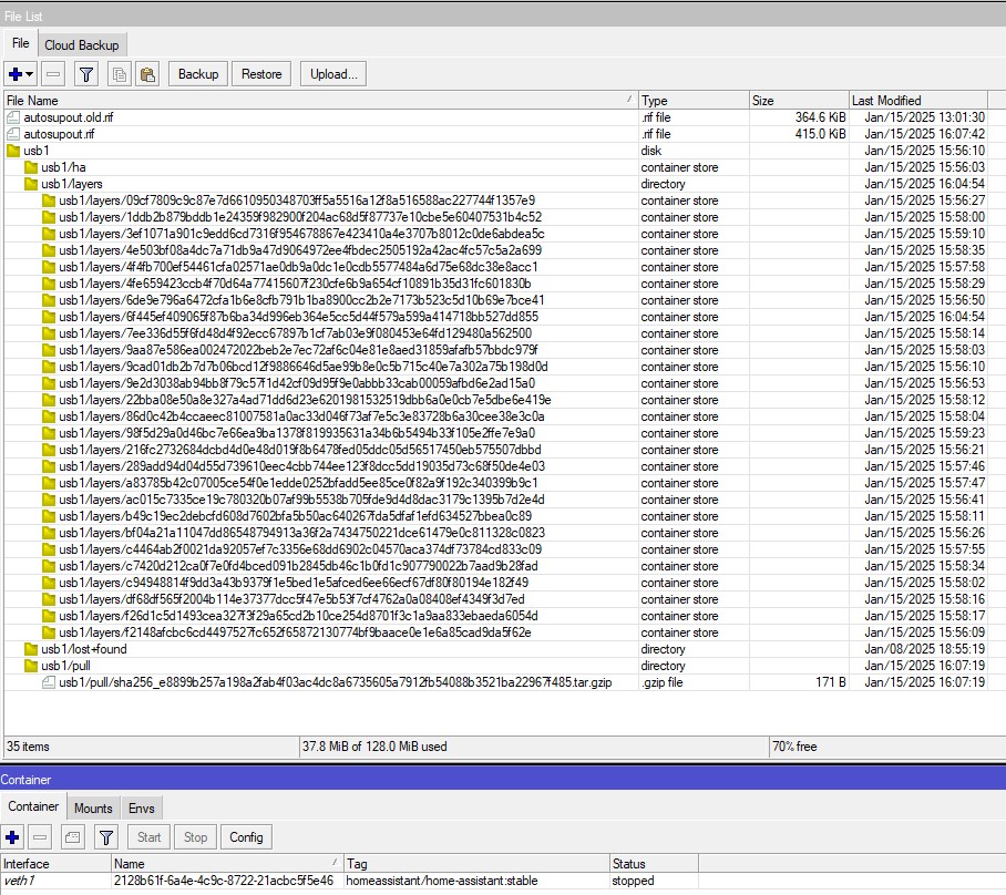

Here you can see the result of my last attempt.
One subdir is made for each file under usb1/layer, however with no files therein?
Also usb1/ha appears to be empty…
I can see that an autosupout was created at the time the process halted..should I send it to MT for investigation?
