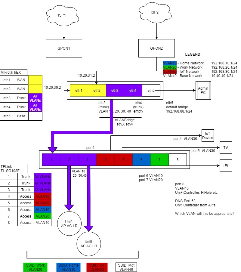

I spent the weekend trying to complete a project I wasn’t able to get to in ages. I wanted to segment my home network into four, and also server all of that through my Ubiquiti Unifi APs. I also have a TPLink Smart Switch between the router and APs. Here is a high level view of my n/w
While I know basics of networking due to my work, I am in no way an expert. But I do know how to google and read docs. I read the almanac thread http://forum.mikrotik.com/t/using-routeros-to-vlan-your-network/126489/1 at least five times before things started making sense. I tried thrice and it broke everything. Turns out that the configuration was complicated due to TPLink and Ubiquiti present in the mix.
The UniFi access point (AP) tags packets when they go out from WLAN to wire. When tagged traffic comes in from the wire, it will untag it and forward it to WLAN.
So the packets arrive at the switch as tagged. This was my first clue :slight_smile: ports 1 (to router), 2 & 3 (to APs) needed to be trunks.
On the switch, if you’re connecting a device that recognizes VLANS (VoIP device etc.), that port should be marked tagged, if not, untagged.

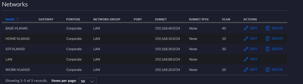

Define Networks in Unifi Controller, mapping each VLAN to a network

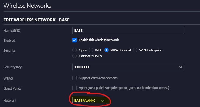

Define SSID in Unifi Controller and tie it to the VLANs created above (Ignore the subnets in this pic, they are of no significant, VLAN is most imp. Unifi has a single page config :man_shrugging:)

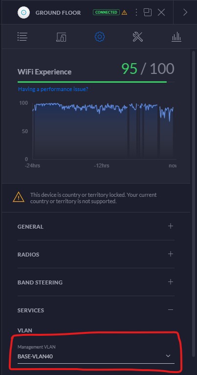

Set each APs Management VLAN to BASE

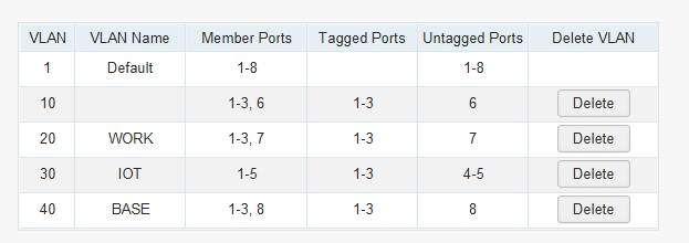

TP Link
Enable 802.1Q VLAN (this is disabled by default). Enable, refresh and move to next step
Map ports based on the network diagram
Set IP of the switch to an available one in the BASE VLAN (after this you will lose connectivity to switch until you complete steps below)

I have something similar except not UNIFI products.
The key is to have a trusted LAN or a managment LAN, and in either case all your smart devices get assigned an IP address from that vlan.
TPLINK is straightfoward.
Vlan1 is the default vlan for every interface and is only removed if the PVID of the TPLINK Port needs to be set to something different (aka untagged to a dumb device).
The rest of the ports are trunk ports and can carry multiple vlans.
HEX, is straightforward.
Vlan1 is the default vlan for the bridge where you have ports 3,4. I like that you have port 5 off the bridge, so that you can access the hex in case the bridge goes nuts…
The tricky part in the config is that the UNIFI are weird beasts at least some models expect the managment vlan to come to it UNTAGGED and the rest of the VLANS tagged.
For example if you use a home trusted vlan for managment it needs to reach the unifi untagged (it can still be used for wifi (assigned to a wlan) along with the other tagged vlans.
In your case going to assume vlan40 is your base vlan.

So as stated now it becomes well how the effff, do I to hybrid vlans on the TPLINK, I can do it on the hex but TPLINK doenst explain it.
Will check out my jetstream in this regard. My guess is that you will simply have to set the pVID of the port to the uNIFI as base vlan, and simply tag all other vlans as trunk to it.
The unifi should then get an IP from the base vlan.

Thank you, @anav. almost all of your observations are spot on.
Right now, my hEX, TP-Link and Unifi combination is working. Unifi needed everything to be tagged, including the management VLAN and then it worked fine.
TP-LINK as VLAN1 as default on all ports and the tagged / untagged combination as I had in my screenshot earlier. Now that I read your comment, I wasn’t getting IP on a dumb device I plugged in on one of the access ports on the switch, and I think I will need to change the pVID of that port to match the expected VLAN ID.
Your firewall suggestions are neat - would you care to point out where was I wrong in ordering them logically?
I went overboard with the interface lists thinking of how I want to expand in the future. I have a few devices in the n/w that I need access from WORK and some that I need to restrict etc. But nevertheless, I think it can be simpler than what I have now. :blush: I am now building a device map of the network and then make a firewall rule table (something that I am used to at work :man_shrugging:)
That should help me define the firewall rules better.
I eventually want to pull the PPPoE from the GPONs to hEX, right now the ISP IPs are set at the GPONs I am behind multiple class C networks. One ISP is straightforward, other not so much. Need more tinkering there! I will make the changes in a few days and post back - work has started and it drains me by the end of the day…
I got around to doing the clean-up and everything looks neat - except the PiHole I have (BASE, IP 10.40.40.9). I can’t figure out why would this drop based on the rules I have :man_facepalming::man_facepalming::man_facepalming:

So the sticking point is your DNS configuration, which is not correct but I am not conversant enough in DNS with pi-hole, or the requirements to give pointers. Hoping others can!!
(1) /ip dhcp-server network add address=192.168.20.0/24 dns-server=10.40.40.9 gateway=192.168.20.1
and
(2) /ip firewall filter add action=accept chain=input comment=“allow LAN dns queries - tcp” connection-state=new dst-address=10.40.40.9 dst-port=53 in-interface-list=LAN protocol=tcp
/ip firewall filter add action=accept chain=input comment=“allow LAN dns queries - udp” connection-state=new dst-address=10.40.40.9 dst-port=53 in-interface-list=LAN protocol=udp
I guess the question is that you need to more clearly state your requirements in terms of your pi-hole server.
Did you want all LAN users to get their DNS from that device?
What are your expectations?
