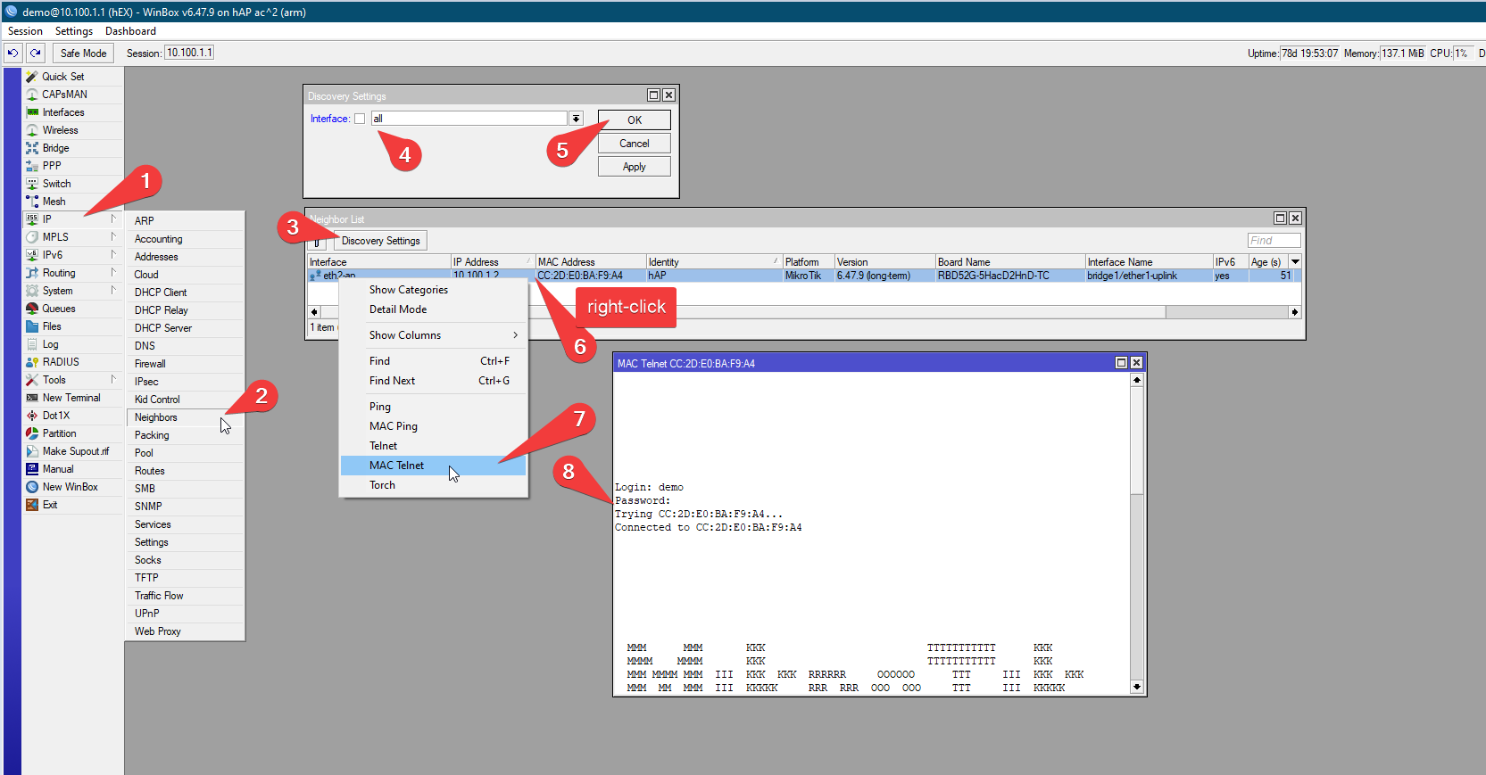

  1. connect hAP and hEX and make sure they are both turn on. If it is working device, you should be able to connect to the hEX in any way you like: winbox (over IP) is fine. SSH is fine. Telnet is fine…
  2. Once you are connected to the hEX from your computer check the ****
/ip neighbor
in the hEX. You should see hAP in there. If not, you may need to enable discovery on all ports
3. Right click on the entry with hAP, select MAC telnet, and it should work
This is how it should look like:
If you did this and it did not let you connect, then it becomes interesting…

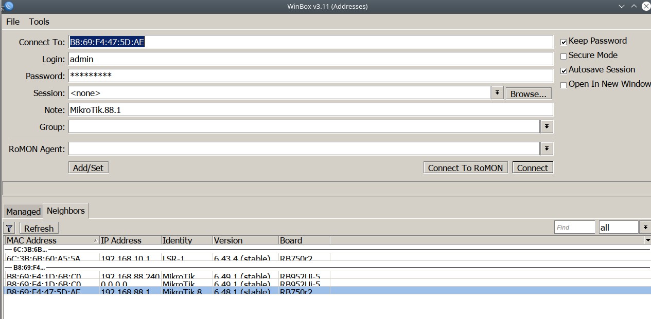

Good info, if only I could get into any of the routers. This screen shot shows where I’m stuck.
