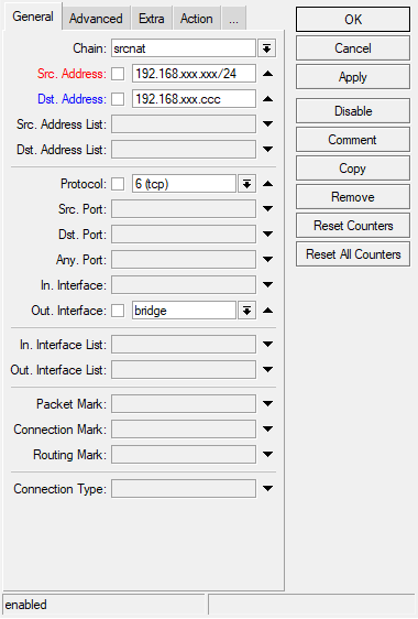

I’m doing similar stuff using mikrotik with my global IP address, when I receive a request from the outside world on port 80 I redirect it to port xxxx of another machine, I needed to use hairpin for this.
But with local dns I’m missing something(hairpin as Amm0 mentioned didn’t work in this case), don’t know why.
In the attachment, you can see my setting for global redirection mentioned above (hairpin), action is set to masquerade.
