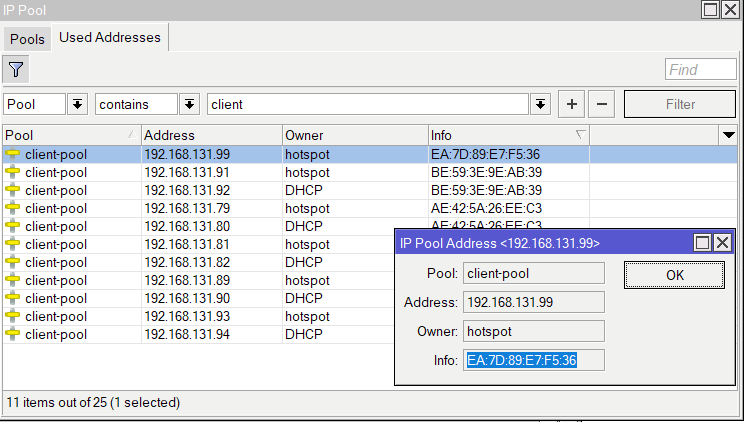

I have 2 different sites that are set up with capsman (around 10 aps) and hotspot. Both setups were set up with RouterOS v6 and User Manager.
Fast forward today I have upgraded to RouterOS v7 and migrated to UserManager v7. Hotspot setup is untouched. Only thing changed is the migration to UserManager v7.

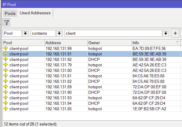

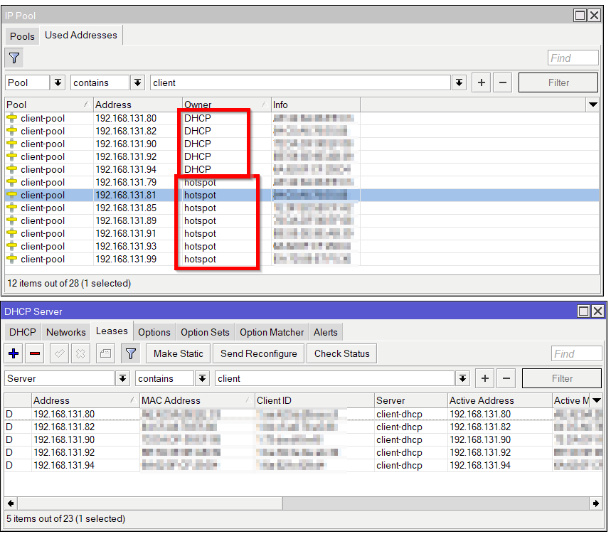

Now, the problem I face is that since 2-3 months ago, on both setup I am getting DHCP pool of wifi clients consumed and it results to no available IP for clients - followed with relevant error in log.
Currently when it happens, I have to reboot the router in order to empty the DHCP pool, because I can't find a relevant command to reclaim all unused IPs of the pool. It goes without saying that I know this is not solution. I have just been so busy that a quick reboot in order to "fix" it for 1-2 weeks was good enough to keep it going.
Could you please point me to the right direction of where to look to see why the pool is getting exhausted? I have reduced Lease time but nothing changed. I am suspecting it has something to do with hotspot.

My main question is why some addresses in IP Pool have owner DHCP and other have hotspot. Because the ones with hotspot owned stay there never-to-be-released until the pool is exhausted.
I mean if I sort by MAC, I can see that for each mac there are 2 IPs from the pool (1 from hotspot and 1 from DHCP). Once DHCP is over, the DHCP owned IP gets released while the hotspot owned stays there. The more I look at it, the more I believe it's a misconfigurtation in either hotspot or user manager.
The following screenshot is now, after having cleared the pool so it's been running around 3 hour max.
I think I found something.
I can see the following MAC Address that is not duplicate and owned by DHCP, the one that will get stuck longer than all the other.
Now in IP -> Hotspot -> Hosts I can find that MAC Address. It has 2 IP addresses, one of the hotspot and one of the DHCP (192.168.131.100) which you can see above that it has already been released.
If I delete this host line marked with yellow, the IP that was reserved from hotspot finally get released from the pool.
