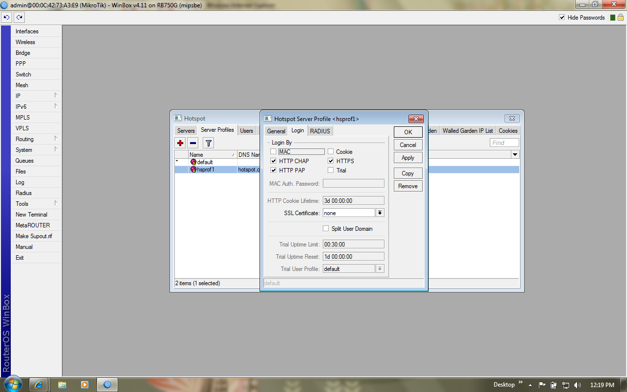

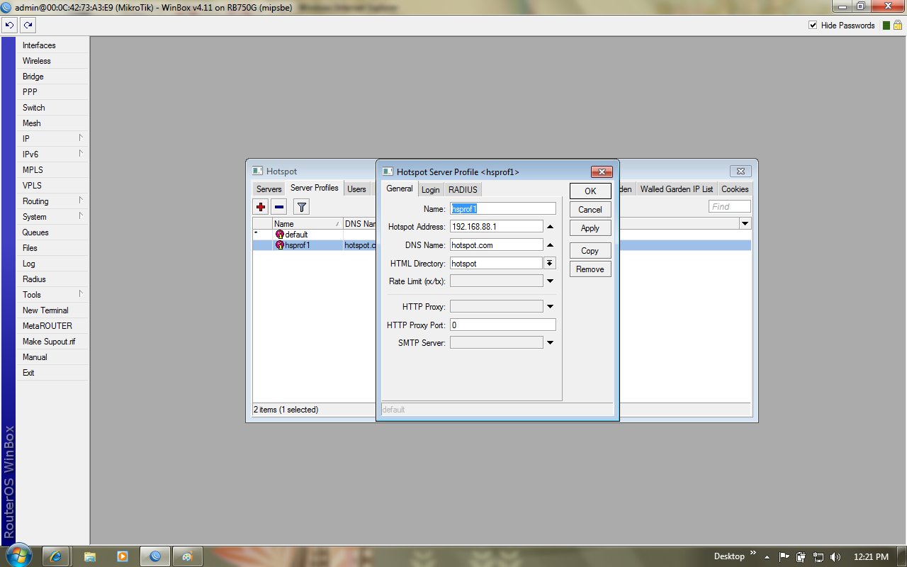

Hi all,
Thanks for you reply. I tryed to follow your instructions, but still dont get a Login page.
Just to get a better understanding....I'm just a bit wondering if I dont have to tell the OS which page it should open when trying to open a webpage?!?When I click on IP> Hotspot > default I can see that under HTML directory it says "hotspot"
shouldnt I specify here which file it should show? eg. "hotspot/alogin.html"?
Please let me know what i should chnage here... Thanks

add dns-name=“Hotspot” hotspot-address=192.168.1.100 html-directory=hotspot \
You do have the wireless card assigned the IP 192.168.1.100, right? If not, it should be changed to that, or go to /ip hotspot profile and change the hotspot-address setting to the correct IP of your wireless card. Insure the dhcp server is also issuing IPs in the 192.168.1.x IP range (except 192.168.1.100, that is!). It all has to be in the same subnet. I would assign 192.168.1.1/24 for my wifi card, and have the dhcp server issue 192.168.1.2-192.168.1.254 and use 192.168.1.1 as the gateway.

FYI: The hotspot profile login-by setting can be deceiving. If you leave the “login-by=cookie,http-chap”, the cookie will supply the login info transparently for 3 days.

Here is what i configured on my box for correction if any for me to have login page display to all connections.
Just as a test, remove the dns name in the hotspot profile. That resolves to something way different here.
