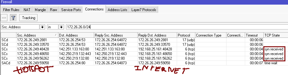

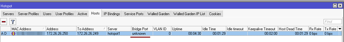

I notice that it uses two addresses from the DHCP pool, one from the client (necessary) and another for the hotspot itself. Why is that?
In the RB connections table, I see connections being originated by the IP from the pool obtained for the hotspot and not by the client’s IP, with the status “syn received”. It does a NAT that I don’t understand how it was done and why. However, I strongly believe that the problem is here.

I using ROS v7.19 and add Picture Connection Table:
