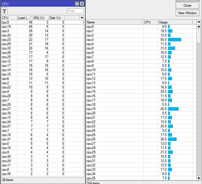

check cpu culprit of usage using tools profile
check how much load has your mos taxed cpu core

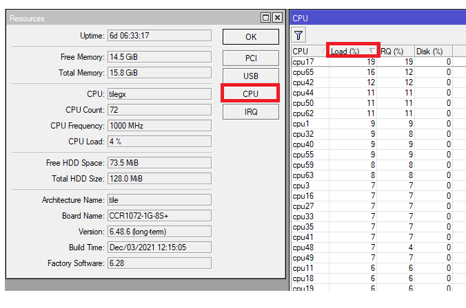

chechito, nice idea distribute the traffic, but in my case its difficult to deploy. I take a print for cpu load, but for me nothings is wrong.
I think hotspot server doesn’t handle a lot of concurrents connections, but there isn’t any config too raise the power of hotspot server.
