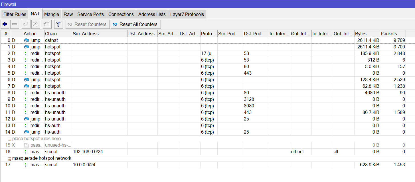

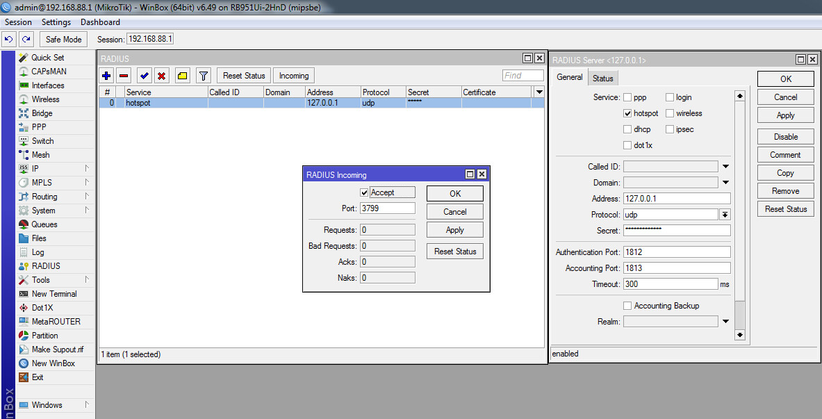

I have a L009UiGS-RM and Hostspot & user-manager is configured on it.
Everything seems to be ok only users connected via Hotspot do not disconnect after their time expires.
Attached my configuration.

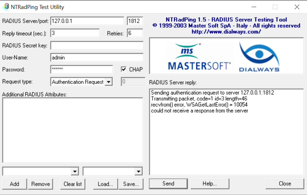

127.0. 0.1 is a loopback IP address that is reserved for the local host or computer or router.
NtRadPing is probably run on a laptop, not on the MT router.
127.0.0.1 would mean the laptops local RADIUS server, not User Manager on the MT router

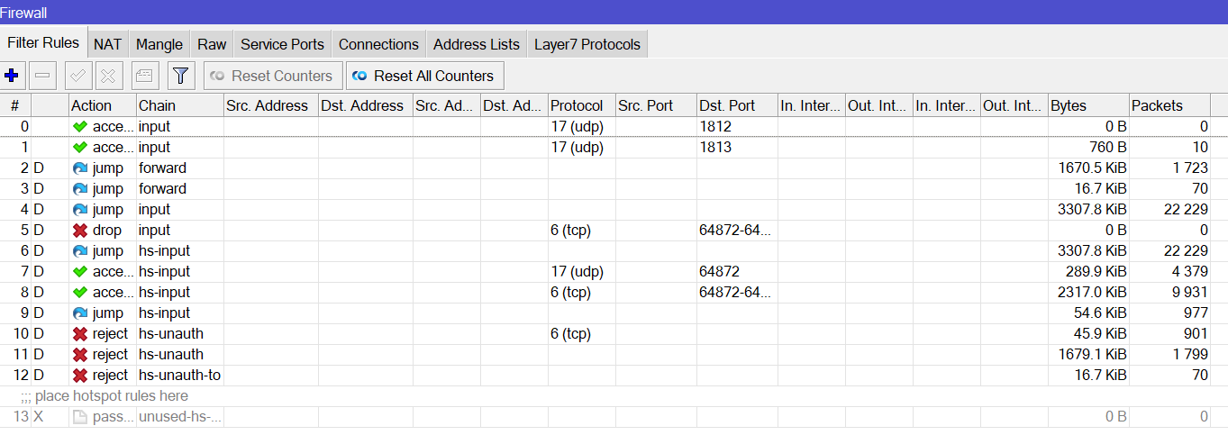

For MT router check the firewall setting, to allow the Radius ports 1812 and 1813 as input.
(Some recent Ros versions have this as deafult (comment says it’s for CAPsMAN, but it is all ports for 127.0.0.1), other don’t have it yet!)
Time limit should come with RADIUS Accounting (1813), and timing set with RADIUS (User Manager) attributes.
I tested with (192.168.88.1) but I still have the same issue.
Yes it’s run on my laptop, how to run it on MT router.

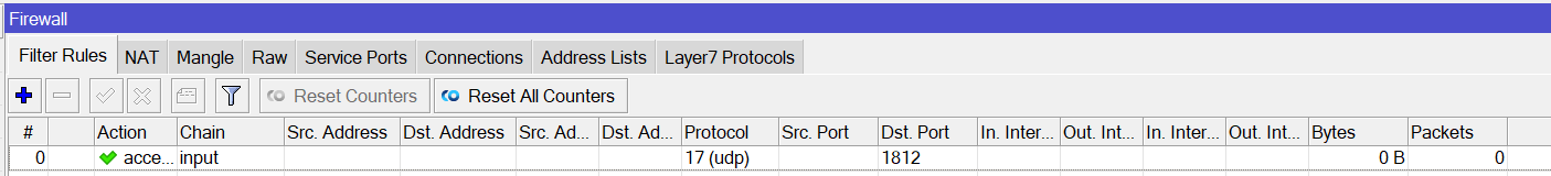

it’s done (see attachment).
It is normally run on a laptop, not on the MT router

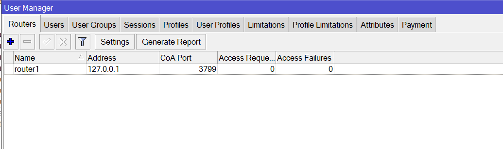

The laptop IP , when using NtRadPing, must be in the “Routers” list of User Manager, or all requests will be ignored. (routers = RADIUS clients list)
Idem for ALL MT routers that use RADIUS, must be in that list, even if it is the same router as the one with User Manager (127.0.0.1 is OK if that one is used as RADIUS SRC address)
