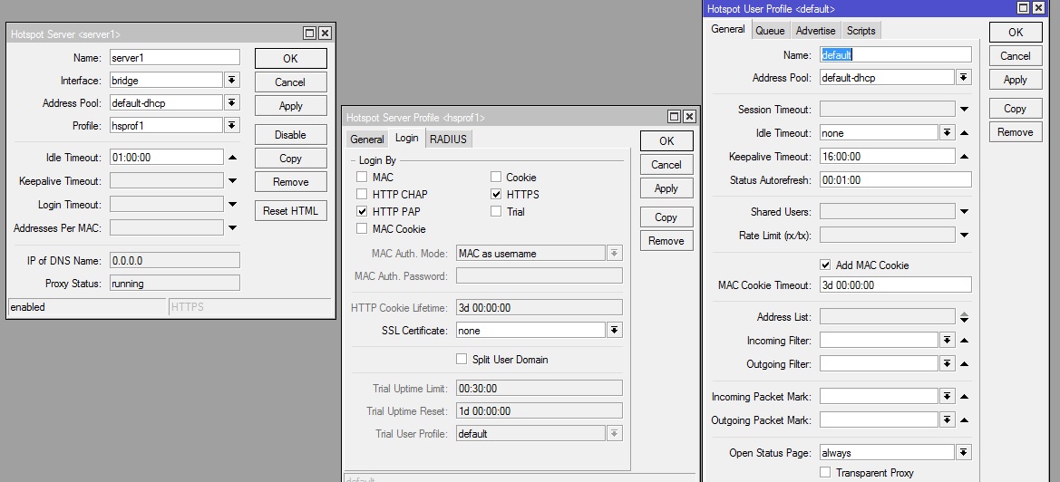

It is my configuration
Mayby somebody have the same problem, please help :slight_smile:
