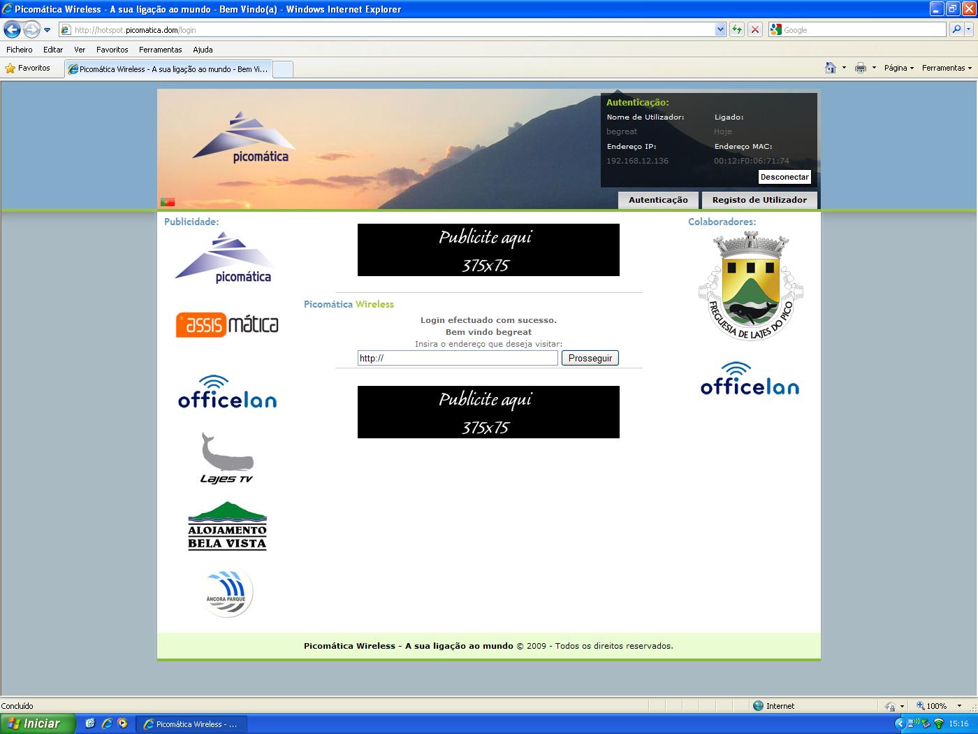

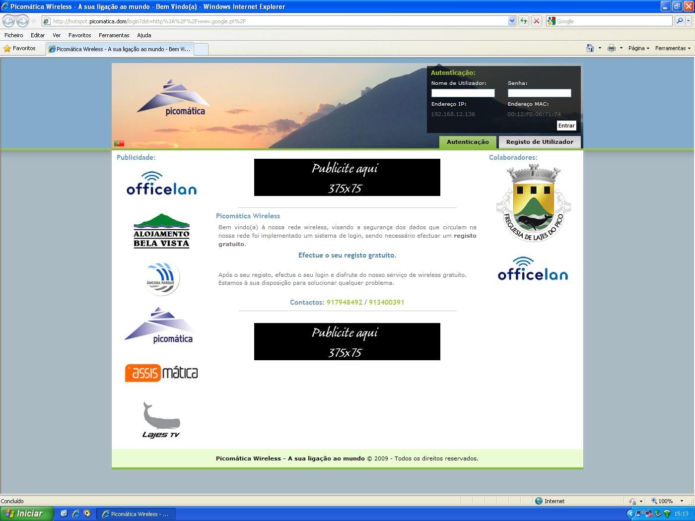

Right now i have a machine set up for testing, when i try to login from the “registar.html” on the browser i get the error:
web browser did not send challenge response (try again, enable JavaScript)
And on the Mikrotik Log i get the error:
begreat (192.168.12.136):login failed: no chap for http-chap login method
That means there’s either a problem how you’re integrating the md5.js, or the $(chap-id) variables aren’t getting populated as Tim hinted towards. Look at the page in source view on the test client and see if the variable is filled out - if it’s not, CHAP can’t work.
