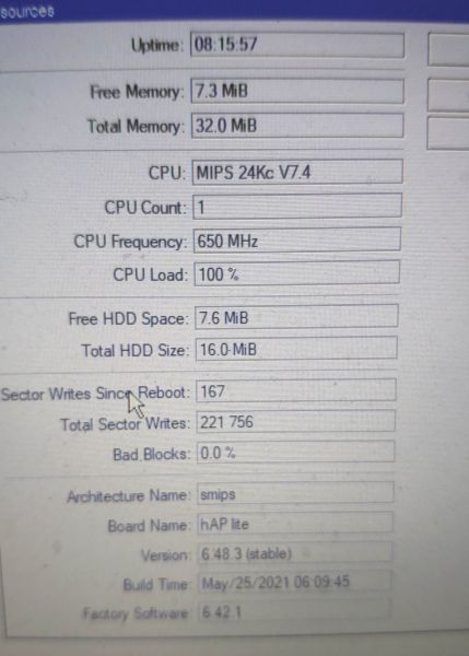

Hi, I have a small hap lite to manage a 3 router in Caps, usually the average load is 2%, ram is fine, FW 6.48.3.

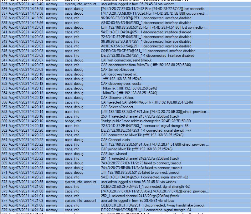

From the log I see caps disconnection, just after the login via Winbox, maybe the problem occours when the system is trying to summarize the status of ther router and send it to me. But I experienced a 100% load for about 1 minute, which is a sign something is wrong here. How can I debug more the problem? How can I know which process exactly overload the cpu?

The problem is the hAP lite (SMIPS)
Use another router to manage the hAP lite, not the hAP lite to manage 3 routers…
If all the routers are hAP lite, do not use CAPsMAN

By chance do you have capsman forwarding enabled? This is a low end CPU and it would be no surprise to see such an issue there.
but why? It has no sense.. if the average load is little, it sould work fine. THere is a simple problem in FW, something is happening wrong in some circustamces. The caps working fine providing roaming and full bandwith with low cpu level.
This is the log:
