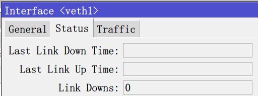

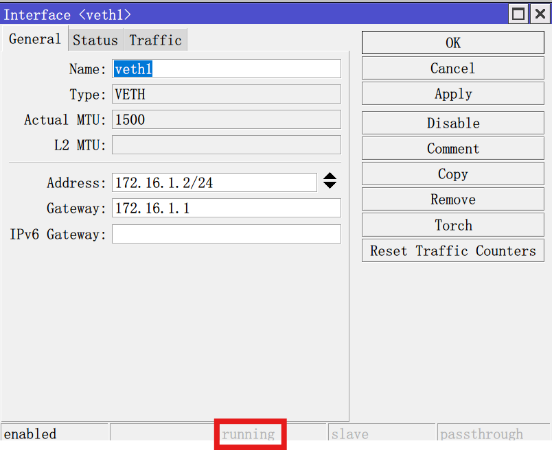

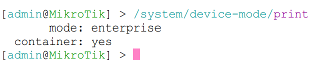

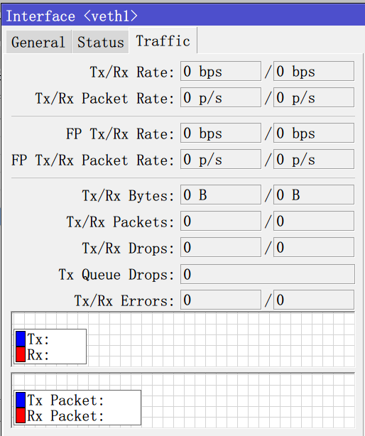

How can I get veth1 to work?
After creating veth1, the running state has been grayed out, I don’t know why. I’ve tried it in RB5009, X86, CHR, without exception, veth doesn’t work, container has started.
Did you assign veth1 interface to that container ?

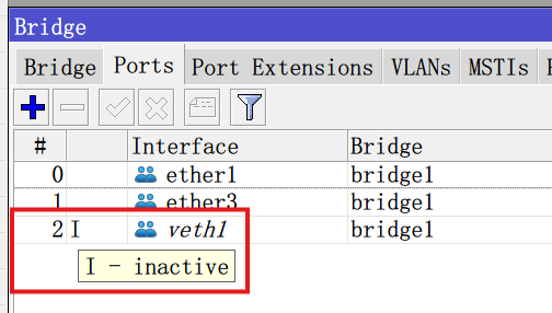

You are bridging VETH to your LAN. So the VETH IP address need to match the LAN. So the VETH need to be something like:
/interface veth add address=10.10.20.201/24 gateway=10.10.20.254 gateway6="" name=veth1
Otherwise, if you want the container to be a separate IP subnet, then you do not want to put the veth1 into your main bridge. You can instead keep the existing VETH as-is, but removing it bridge, but assign the VETH an IP in the subnet used… so:
/ip address add address=172.16.1.1/24 interface=veth1

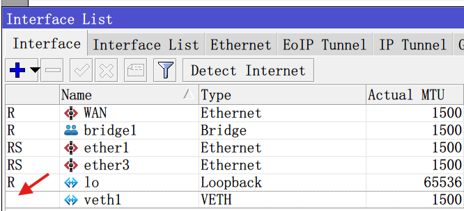

What’s new in 7.16 (2024-Sep-20 16:00):
*) container - clear VETH address on container exit and mark interface as running only when VETH is in use;

Veth will be running when container will be running.
Check:
/disk print
is storage device called disk1?

I am getting an empty response but the container status is running.
So disk1 is getting created on the flash, with the path of “disk1”…
Do you have a USB or other disk connected?
Because… you may be out of disk space on the flash… Check /system/resource/print and look at free-hdd-space.
