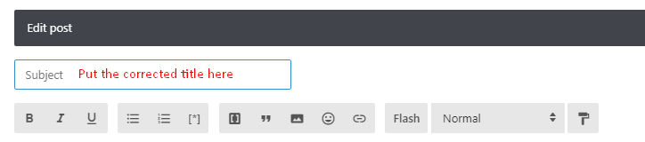

Yes, please do. This has nothing to do with High-bandwidth Digital Content Protection HDCP
And so other users in the future wanting to do something similar will have a better chance of finding it, please edit your original post, and change the title to something meaningful like
"How can I graph DHCP leases?"
It is easy to do. Here's how:
