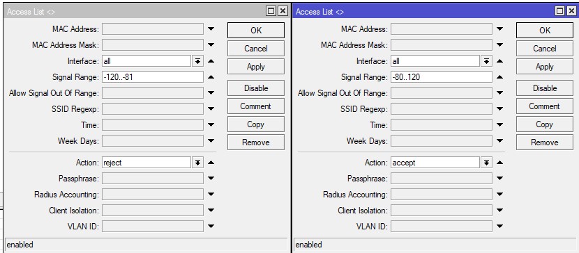

I also created these rules in access list to try to make the client roam to the best AP

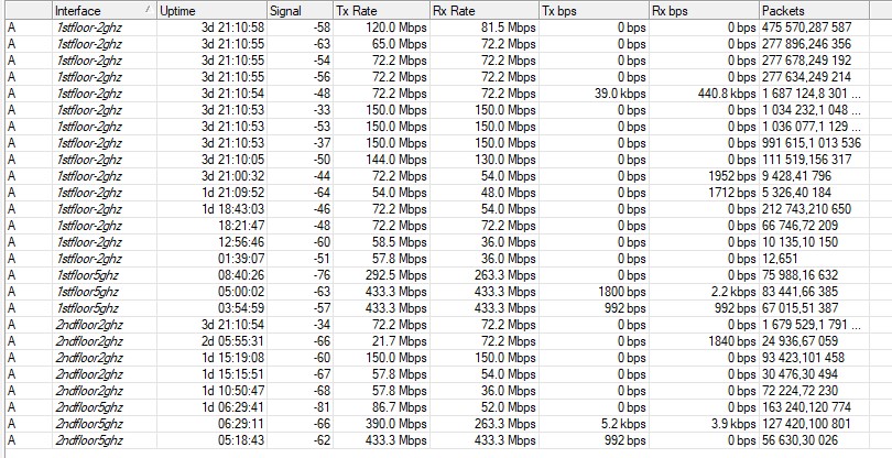

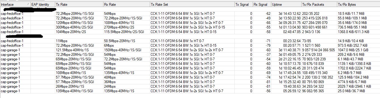

Please find below both registration tables:
