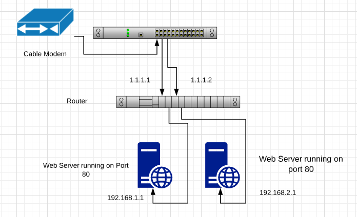

I tried the NAT rules, but that doesn’t appear to be working. I can’t access the device that the second public IP is NATed to. What I had tried the first time and failed with is to run the modem into a switch and break out 2 connections from there, use one for IP Address 1, and one for IP Address 2, then set up a bridge on 2 ports. one for WAN and one for LAN. I leave the working config untouched on IP 1, and on the new bridge, I set the wan as IP2. In theory, I thought I could basically set up a second 2 port router on its own bridge with just 1 WAn and 1 LAN, but as soon as I set the WAN IP on the new port, I lose access my WAN connection, nothing in or out. Why is that? that seemed lilke an easy solution.
Something like this
Bridge 1
eth 1 Gateway 1.1.1.1/24
eth 2 LAN 192.168.1.1/24
Bridge 2
eth 3 Gateway 1.1.1.2/24
eth 4 LAN 192.168.2.1/24
Does the Hardware Bridge still exist on ports 1-5 and 6-10? If I move my bridge 2 over to ports 6 and 7, would this work?
Okay, I am getting closer. I set my second public IP address on eth 1 along with my other public IP, so x.x.x.40, and x.x.x.41 are both on my eth 1 interface. I am dropping about 99% of my pings to the second address, but every few minutes, one gets a reply. what would cause that? I set 2 statics on a test rb3011 I have, and it worked perfectly. what would be causing the routing issue?
Your router/switch/bridge configurations make no sense to me as typically in my limited experience, bridges are not used to combine WAN and LAN ports.

It is a problem with solution as you describe it when two interfaces come into play. In this case simple src-address replacement (as done by DST-NAT in reverse direction) does not take care of using correct outbound interface. If, however, both public addresses are using same interface, there’s nothing to be decided upon by routing engine.
My guess is that @kd7vea’s problem with only 1% of pings working is about this … if both public addresses are eventually routed through single WAN interface (north of the switch through cable modem), then it doesn’t make any sense to deploy two WAN interfaces on the main router. After change (assign both public addresses to single interface) router has to flush all tracking information … the easiest way of making sure nothing remains in cache is to reboot the router.
