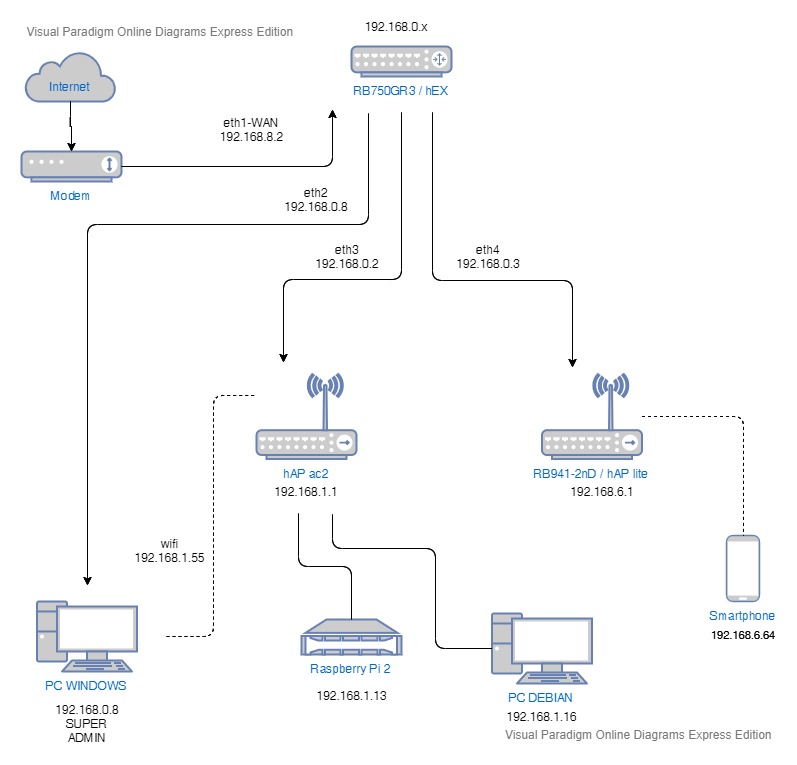

This is my third MikroTik hAp ac2, just bought a view days ago.
In the diagaram, i always work at Windows PC [SUPER ADMIN] (192.168.0.8 ).
I cannot connect to all 192.168.1.x, like to Raspberry (192.168.1.13) and debian (192.168.1.16).
If i turn on my wifi, connect to hex ac2,192.168.1.1, get IP 192.168.1.55, i can communicate both raspberry and debian.
All internet access is success. And all router is in their own NAT.
I already search but i dont understand , some people say NAT, some people say port forward, im newbie.
Please help me, i can post what you need for more information.

What I do not understand is why you have the HAPACs acting as routers? Why not just use them as access point switches.
Then all can be on the same subnet?
In other words without understanding the use cases, groups of users and their needs which have driven you to this setup, its hard to understand or advise.
I would simply use one ROUTER, the hex for all routing purposes and then if I need separation amongst users use vlans…
In this way it would be dirt simple (less complex, no double nat etc) to give admin access to wherever you needed it.
Before all was same setup, except its was ASUS RT-N12+ as a bridge before i bought and replace it to hAPac2.
ASUS was a bridge with same 192.168.1.1, DHCP server from HEX, i can connect easyly to 192.168.1.x.
My work area (192.168.1.x)The raspberry as a local web server for developing web, and other stuff like smart home stuff and CCTV.
The setup is to protect 192.168.1.x from all mobile user that IP from 192.168.6.x (my dads employee).
ITs hard to change so many 192.168.1.x in that raspberry and inside my PC
I tought dhcp server from hex for ASUS wil hurt their performance, so thats why now i setup each router has its own dhcp server.
So, is it OK to have one dhcp server in HEX for other hapac2 amd hap lite?
But still set the subnet as in the diagram?
I agree with anav. Let the hex do all the routing and DHCP, and use the hAPs strictly as access points. Use different VLANs to keep things apart as needed.
