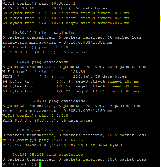

Hi
Am new here and i need help
I have switches and routers that are managed through internet but the problem is that they are being blocked by the Mikrotik CRS yet other devices are getting internet
The mikrotik is the Internet router and the public IP is configured on it.
There are no VLANS configured and neither are there Firewall or NAT rules
