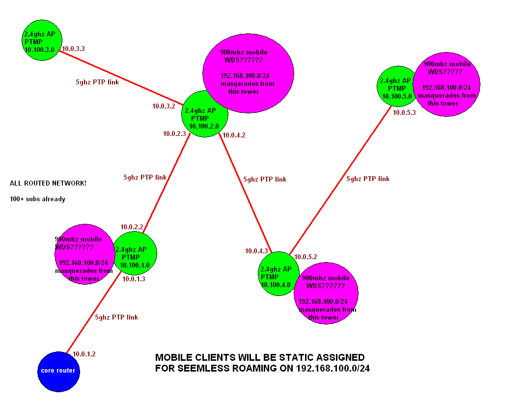

I already have a countywide routed backhaul setup in place and I want to add an AP to each of my existing sites that will be the “mobile clients” ap only and use the existing backhaul.
Now I realize that i need to have each of these AP’s (for the mobile clients) setup with the same SSID and FREQ in order for the seemless roaming. Since my network is routed i will setup NAT on all of these AP’s and put them all on the same subnet so that these clients can immediately switch to another AP without worrying about dhcp issues (clients will have fixed IP’s)

Do you have a network diagram? I’d make the WDS links over the wireless backhaul. Then your other radio, I’m guessing 2.4GHz, is free for the clients and you can use different channels. You’ll have to change to a bridge setup.
Here is my network diagram right now. As of right now the PURPLE 900mhz AP’s are not there but this is so you can get the idea of what I want to do. Basically I already have a 5ghz infastructure I just want to add the 900mhz for roaming and utilize my backbone already.
