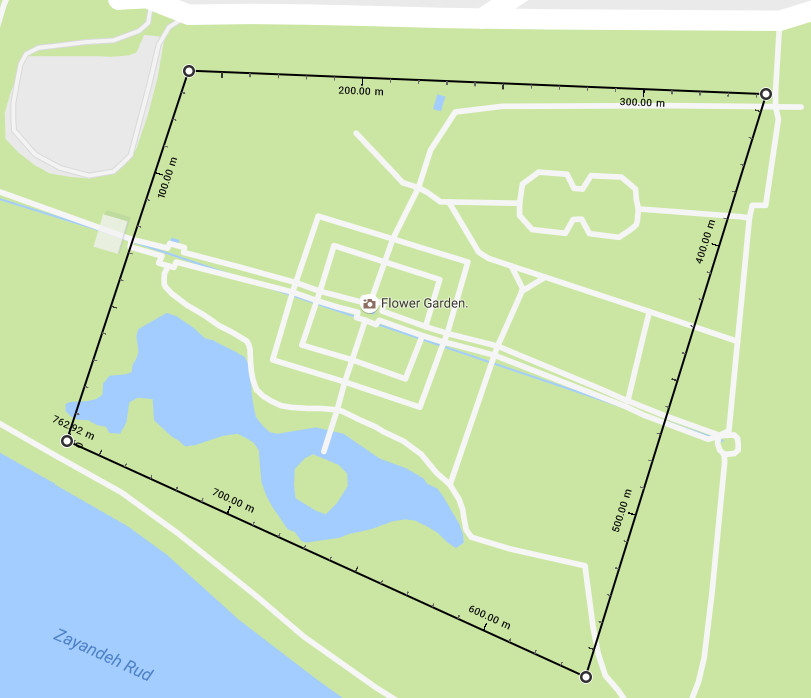

I want to full covering wifi signal in 4500 Square meters for smartphones hotspot. my question is how many device need for mesh networking and which routerboard model is recommend ?

It will also depend on how you can mount them.
E.g. in the center of the park you could mount 4 units with 90deg sector antenna each covering 1/4 of
the park and you would not need mesh network (this would be an advantage).

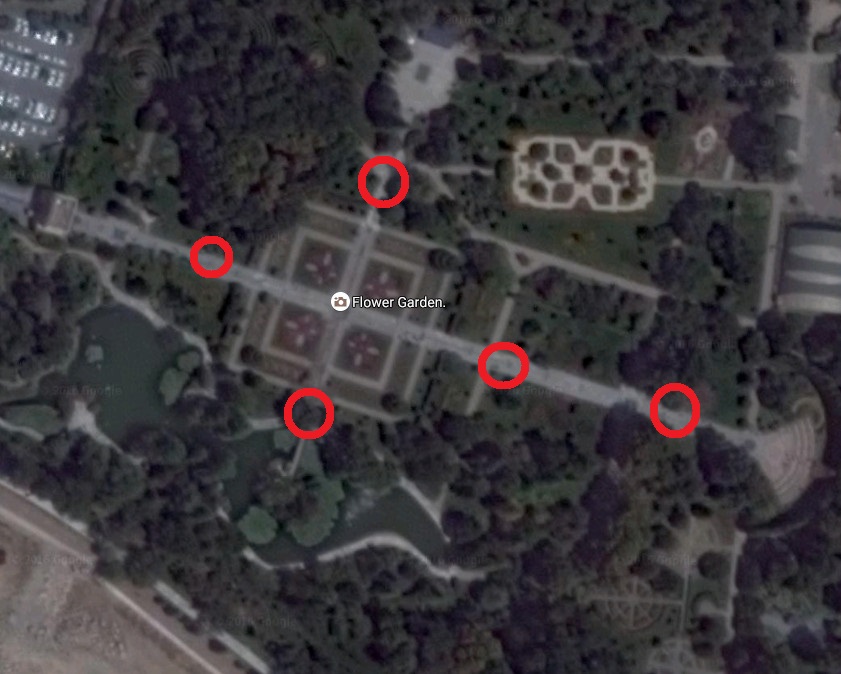

about mesh network: I mean Roaming all AP’s together for example roaming 10 RB951Ui together
Use sxt2 and sxt5 or similar sectors with at least level 4 license as ap in the center. Bridge them together and use the same ssid. Clients will roam and stay connected.
If you can run wires around, putting these APs into corners would be much better than in the middle as they will be far away from each other so there will not be a risk of mutual interference. Keep tx power as low as possible.
You need to change your thinking, you need to start from weakest point in this setup - as it is park, it is client devices - mobile phones and tablets. You need to find out what is average distance they can transmit data back to AP.
remember that Wi-Fi communication is bidirectional, not only phone need to see Access Point, but also AP need to hear phone.
I had one similar setup once, we had to use every other light-poll in the park with small Omni wireless device, now i would probably use something like wAP ac, using 5Ghz for backbone and 2,4Ghz for clients.

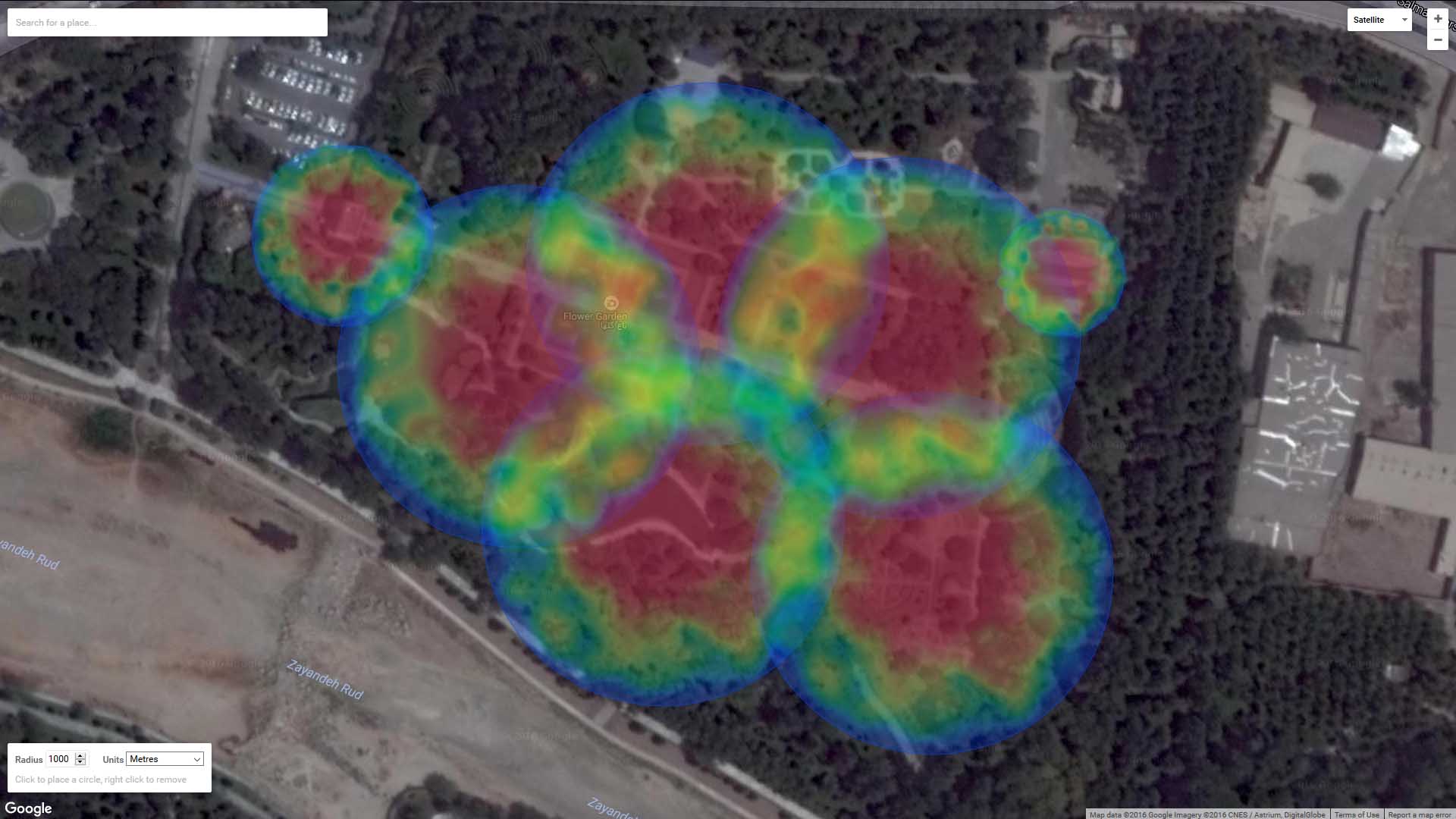

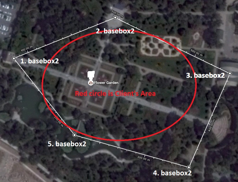

I want to do this with 5 basebox 2 + 9dBi antenna for roaming network I think it can works.
The tree’s in this park is small
What is your opinion ??
It can work if the clients will be able to deliver their signal to the APs. Omnidirectional antennas need to be put closer to the center while panel antennas could be more on the edge.
I am really confused for this project ![]()
what can I do now ? moving omni antennas to the center of the park ? like blow picture
Yes. Exactly like this. Put the omni antennas not higher than 2m.

Can I use WDS Static Mesh in this project ?
It is not smart to use the same radios for distribution and for clients connection at once. Rather avoid the wds mesh and use cables to connect APs to the uplink or use another radios (5g preferably) for the interconnection.
Finally I build my networks with five BASEBOX2 and 2 RB951Ui in WDS Dynamic MESH and worked like a charm ![]()
