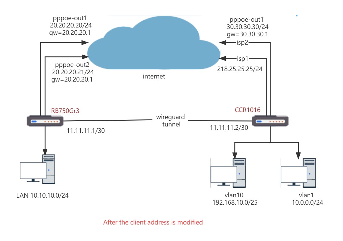

How should I configure a site-to-site VPN tunnel based on wireguard in a multi-wan environment?
Checked the official wiki document, the configuration is successful, the mikrotik devices at both ends are v7.7, just a few days ago, the mikrotik device at one end (rb750gr3) was upgraded to the latest version of v7.8, and then it didn’t work, and the other end Also upgraded to v7.8, still can’t access each other. The only difference between my network situation and the official wiki is the multi-wan environment. The Internet at both ends of the wireguard tunnel is a single wan (isp). Not interoperable. May I ask how to solve it? In order to facilitate understanding, I drew a simple network topology diagram according to my network layout.

First comment is that it is not clear if which router is considered the server for the initial handshake and which one the client.
Second comment why do they both have 0.0.0.0/0 selected at peer allowed IP settings.
Typically one uses 0.0.0.0/0 at one end to signify that users local on that device are going to the other router for internet…
Thirdly the diagram is wrong, the IP addresses for wireguard seem reversed…
The problem is solved, just add a routing mark on the rb750 route
chain=prerouting action=mark-routing new-routing-mark=main passthrough=no src-address-list=local-LAN
       in-interface=bridge2-LAN
