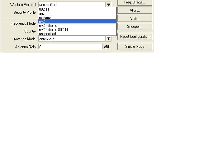

Dear All
I have 2 sxt 5hnd but .. I activate N stereme ok but dont enable to activate NV2 protocol
I transfer 30Mb per second for 4 kilometer
I want nv2 to increase data rate of transmtion
Dear All
UP UP
any answer??
go to wireless, press wireless tab and protocol choice nv2 in both sites, first the remote an after local
Better to set to “nv2 nstreme 802.11” on remote end as this means it will try nv2 first then nstreme in case you have problems with the local end configuration or dropouts.
thanks for all
no, it just means that it will connect to whatever the AP is set to.
Sorry, clarification: It will connect to the Nv2 enabled version of the same SSID rather than an Nstreme one (if both options were/are present).
Also means you can switch the remote client end to “nv2 nstreme 802.11” and migrate the AP side from Nstreme to Nv2 knowing that if it something doesn’t work you can switch back to nstreme and the remote side will still connect back up.
yes, like that
