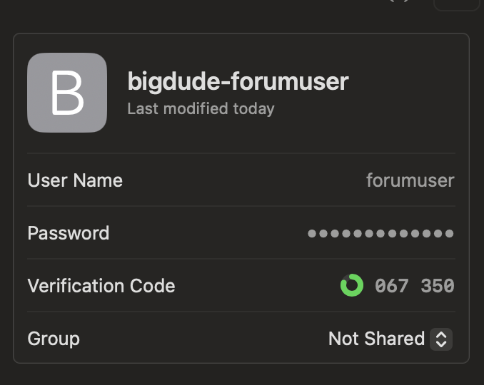

I tested on MacOS, and in Tabby terminal, the clickable link works which takes you to the native MacOS Password application that support TOTP.
In Passwords, it will prompt you create a keychain item for it, including username and password, and will show the TOTP code with item in Password app. It does not actually use the username/password since RouterOS does not use keychain — but the TOTP code needed after password in RouterOS will be generate and works
