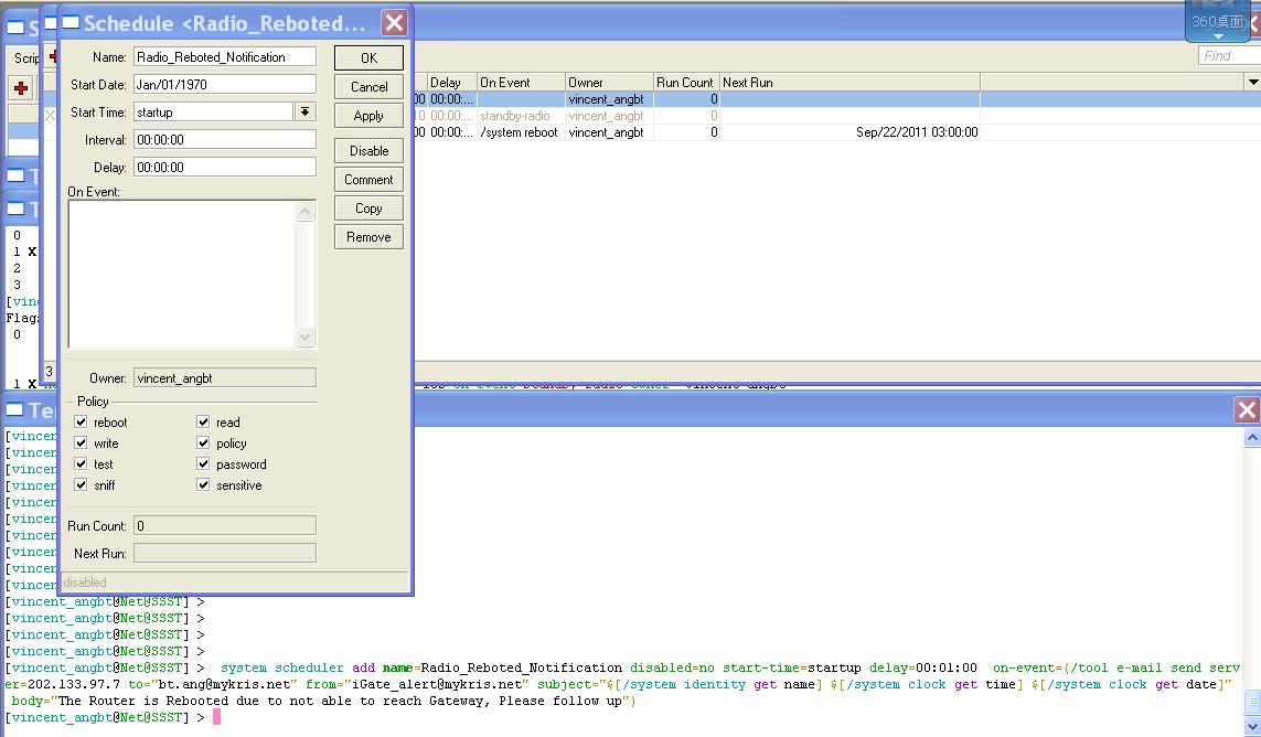

Hi Fewi..
i have try this way…

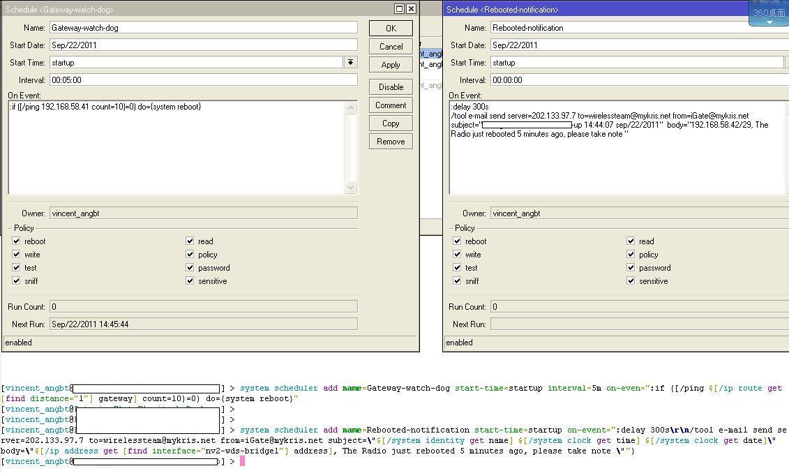

system scheduler add name=Radio_Reboted_Notification disabled=no start-time=startup delay=1m on-event=(/tool e-mail send server=202.133.97.7 to=“bt.ang@mykris.net” from=“iGate_alert@mykris.net” subject=“$[/system identity get name] $[/system clock get time] $[/system clock get date]” body="The Router is Rebooted due to not able to reach Gateway, Please follow up)
but what i found is, it’s not working and no content in the “on-event” the delay time also cannot be set.

it seems that on-event do not contain any quotation. That might have worked before, but 5.x requires stricter syntax. So try to add quotation and check results.

Dear janisk …
I have successfully to make it..
But some how, the script will auto convert the value into my system scheduler.
this become another issue that, when i change the system information or some other value later on, it not able to update the system scheduler.
how can i make it, in the new terminal, the script i paste that, in the system scheduler, it will show something like “$[/system identity get name] $[/system clock get time] $[/system clock get date]” instead of auto-convert it to the system value into the system scheduler.

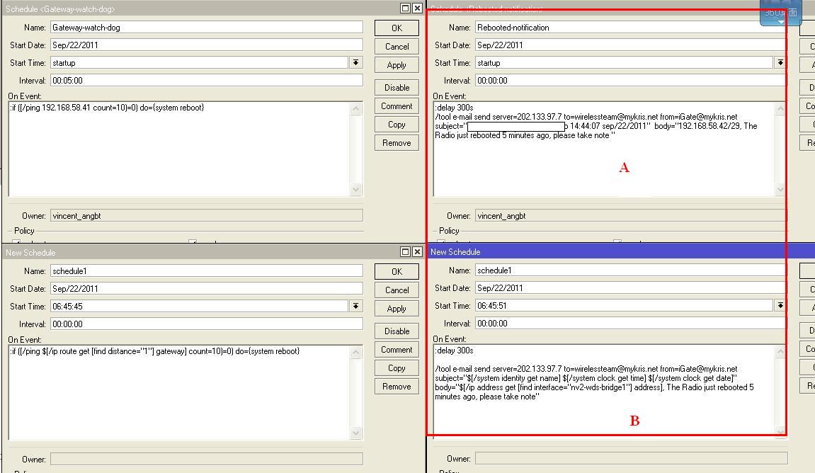

i think i have mislead..
what i mean is, when i paste "$[/system identity get name] " in the new terminal, inside the system scheduler on-event, it will shown "$[/system identity get name] " instead of the “system name”
how can we make it?

Hi…
Yes, i did that, but that will not auto update if there is any system information changed.
i would like to make it after paste the script in the new terminal, in the system scheduler on-event will shown the script as B instead of A.
