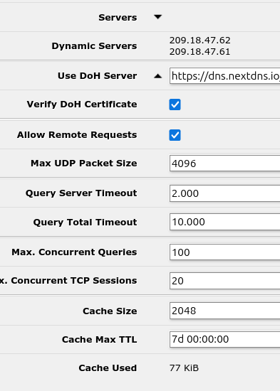

So I tried it and I'm not sure I did it right but here's what I did. Can't paste into the terminal in webfig so I downloaded winbox and opened the terminal in there. I tried pasting the entire paragraph of code at once and it failed. I'm assuming that notepad adds empty space or something that screws up the code so it doesn't work.
So I decided to do it one line at a time. Good idea?

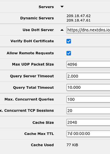

Anyways it "looks like" it worked correctly I guess. I see the numerous certificates in there now and as you can see from the attached pic (if that works) it did something with the DNS entries. But it has "dynamic servers" there that I don't think was there before and I don't recognize those numbers. Should they be there?
Those IP addresses are received through your DHCP client. You can disable this by setting use-peer-dns=no.
Another dumb question but ... where/how do I do that?
Either dhcp client (/ip/dhcp-client) or pppoe client.
Found it. Thank you!
Yep. Basically, the canonical config - and the one the directions you found are pushing you toward - is to only have DoH configured with no other static or dynamic dns server. Looking up the DoH server is done using static entries.
