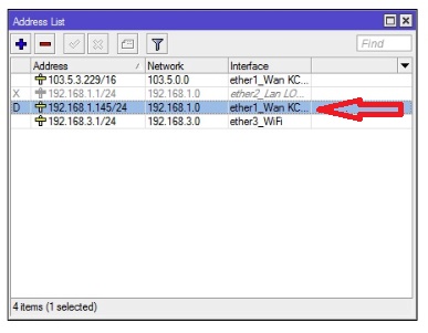

Guys please Help, May Mikrotik router automatically generate an IP: 192.168.1.1 in address list and my internet automatically disconnected. Thank you in advance.
Follow up to my post earlier.
Have you ever encounter a duplicate wan IP address (Sample 192.168.1.100) automatic create to my ether1 to my mikrotik router with out adding it, and my internet automatically disconnected. How to resolve this kind of issue int Mikrotik Router. Thank you so much in advance.

Hi Sob, I apologies it will not happen again thank so much you for your prompt reply. By the way here is the image of the ip that automatically adding to my router. i have already check all my Ap and all of them are set to disable the DHCP.
It has “D” flag, which means dynamic. Go to IP->DHCP Client and I’m sure you’ll find a client on ether1_Wan_KC… interface, and that’s where it comes from.
