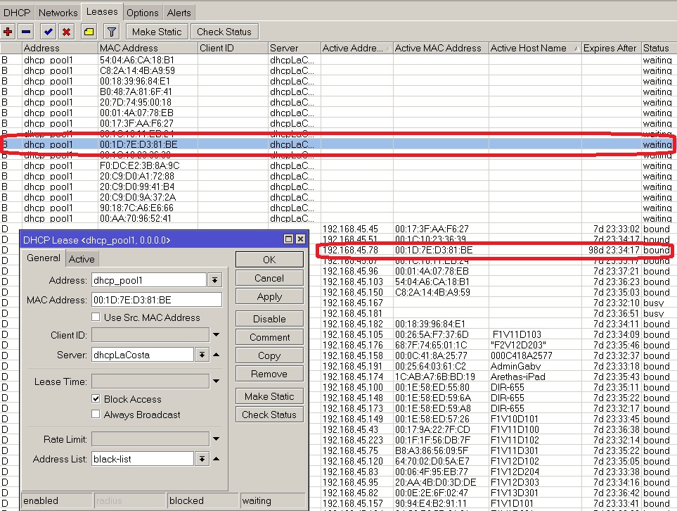

IP → DHCP Server → Leases → Add new → General=“Pool_Name”, MAC Address=“MAC address of desired blocked”, Server=“Name of DHCP Server failing”, Block access = yes, Address List = Black-list

I tried this and the offending MAC addresses still got their IP address perfectly OK. Not only that, but as can be seen on the attached file, one of the offending MAC addresses ALSO got a lease for 99 days instead of the 8 days programmed in DHCP server, like all other leases.
Note: I DO NOT have a list of addresses called “black-list”. I did, however, try first with that box empty, with the same result.
I rebooted the whole system each time.

when you block a mac address in firewall filter (forward and input chain) you block internet access and not dhcp lease.
add chain=input src-mac-address=aa:bb:cc:dd:ee:ff action=drop
add chain=forward src-mac-address=aa:bb:cc:dd:ee:ff action=drop
if you want to block dhcp lease…
- set a dynamic lease to static lease “make static”.
- tick “block access” to static lease. restart the router (or wait that static lease to expire) and the specific mac address will not get address from dhcp.
