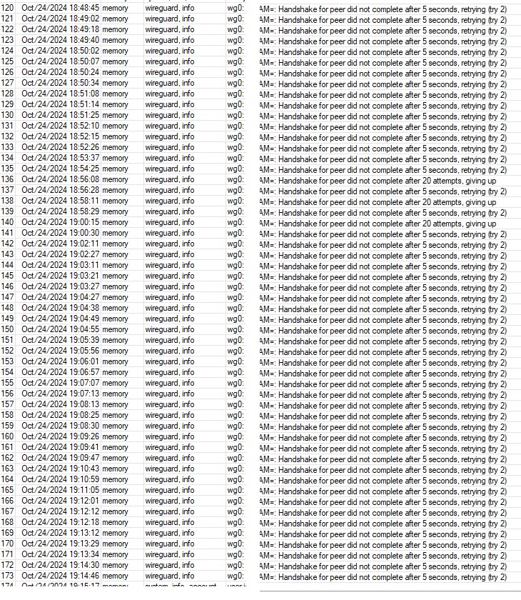

How to change WG handshake timeout
Is there any way to change the timeout from 5 seconds to give the system a little more time before logging the error:
“handshake for peer did not complete after 5 seconds, retrying”

Maybe you can then tell me how to stop this so that there is not so much log and also more network requests?
And all this only after disconnecting the client device from the Mikrotik router server
It could be due to several things, like having a WireGuard peer acting as the initiator (ie you have defined the endpoint-address and port) but the receiver isn’t responding, or for some reason an established connection has stopped working. An earlier version of Ros logged way too much by mistake but I can’t recall what version it was.
