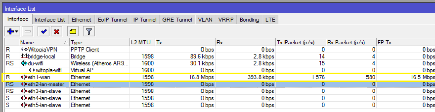

I have been using an RB951G-2HnD for 3 years now without any issues. However, since last weekend the internet has become slow all of a sudden so I started investigating.
If I bypass the router and the broadband cable directly into my my notebook, then the speed is a 100% fine so it has something to do with the router or the traffic going through it..
In Winbox I saw that the CPU’s load is constantly high, jumping between 80-98% - I don’t remember it being so high.
I checked the Interface list in WinBox and saw something strange:
eth1-wan (the port I connect the broadband cable into) has constantly high Tx (10-17 Mbps)
I checked if any neighbors could be using the wifi but no, the only devices connected to the wifi are mine. I have a Synology NAS which was not reporting any traffic higher than the usual few kbytes per second. I unplugged it’s LAN cable from the router the high Tx still remains.
If you look at the attached screenshot you will see that there is no Wifi traffic, there is no LAN traffic on Eth 2 to 5, then how can there be so much constant traffic on Eth1-wan? I am not an expert but am I wrong that Tx traffic on the Eth1-wan port should come from either one of the 4 LAN ports (Eth 2 to 5) or from wifi? But as you can see it does not come from LAN or wifi, then what on earth is this?
How could I find out what is generating all this Tx traffic? Again, this only started about a week ago.
As this is starting to worry me, any help would be greatly appreciated!
Thanks a lot in advance.
Like always here. Dns amplification attack. Why you can’t read all other threads with the same symptoms and implement firewall rules that block incoming connections to port 53? Your firewall is unsecure if you need this.

Well, a DNS amplification attack is when someone uses your machine to flood someone’s else with DNS responses. First they (the miscreants) must find your machine, and verify that it is open to this attack. This is made by bots, crawling the entire web space. So, it is a chance game: your machine can be “found” in 5 minutes online - or can go on, unnoticed, for quite some time.

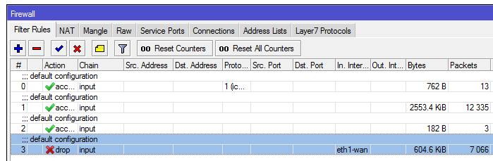

This option sounds fine. I tried copy pasting it into the terminal via Winbox but I got a “syntax error (line 1 column 24)” error message. I also tried manually entering, navigating to ip / firewall and then start with add action but as soon as I start typing “add”, after the letter “a” “address-list” comes up as a suggested command.
Edit: I just now realized that I have a a Filter rule that might be the same as what I was trying to add? Please see the attached screenshot, is rule # 3 the same and is that why I cannot add it as it already exists?
Thanks again for your help.

Yes, that’s the one. But if you already have it… must be something else. It is enabled, right? If it is enabled, do like R1CH said: run a torch on the interface (don’t forget to enable protocols and port numbers), and find out what it is.

I had this rule there from before, my IT friend who had originally set up these routers for me put that rule in there but it was disabled until recently.
So what happened was (as a mentioned in one of my prev. posts) I was having the issues because of possible attacks on the other router (let’s call it first router) but as they are the exact same model I just exported all the settings into this second router (which was not in use anyways). I reset its settings with no defaults, then imported all settings (incl. firewall ones) from the first router. And then the unknown Tx traffic was gone but the drop rule was still disabled at the time. Which I didn’t understand as it had the exact same firewall rules as the first one. That is why I was asking who it is possible that you have two routers which are virtually the exact same routers with identical settings and one generates the unknown Tx traffic, while the other does not..
