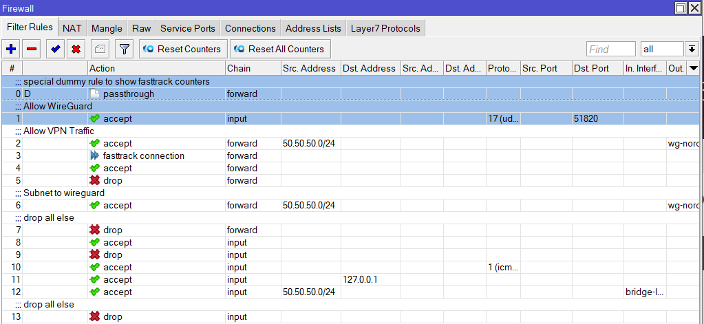

Your config rsc is fine, regarding security,
As for observations, just two…
a. WHy do you have this rule???
add action=accept chain=input comment=“Allow WireGuard” dst-port=51820
protocol=udp
b. why do you have this rule out of the order for forward chain rules and especially when it already exists in the proper order ( aka this is an unecessary duplicate )
add action=accept chain=forward comment=“Allow VPN Traffic” out-interface=
wg-nordvpn src-address=50.50.50.0/24
protocol=udpb. why do you have this rule out of the order for forward chain rules and especially when it already exists in the proper order ( aka this is an unecessary duplicate )
I ve only rules you pointed me out, didnt add extras. What do you want me to adjust? Oh never mind, those added by the config when i insert it. Just tell me how you want them or to be erased, dunno.
Just remove, delete them LOL. do you use winbox?
Yes brother. Want me to delete those two highlighted?
Just the one dealing with wireguard and do you know why it is not required??
You told me, cause right below it there is another rule that does this job, right?
No that is for the firewall rule that is duplicated which you did not highlight, the reason is there is no incoming handshake to the router for establishing the vpn connection, its your router that is sending out the intitial handshake and thus its the remote end (if mikrotik) that would need such a rule.

Fine now?
