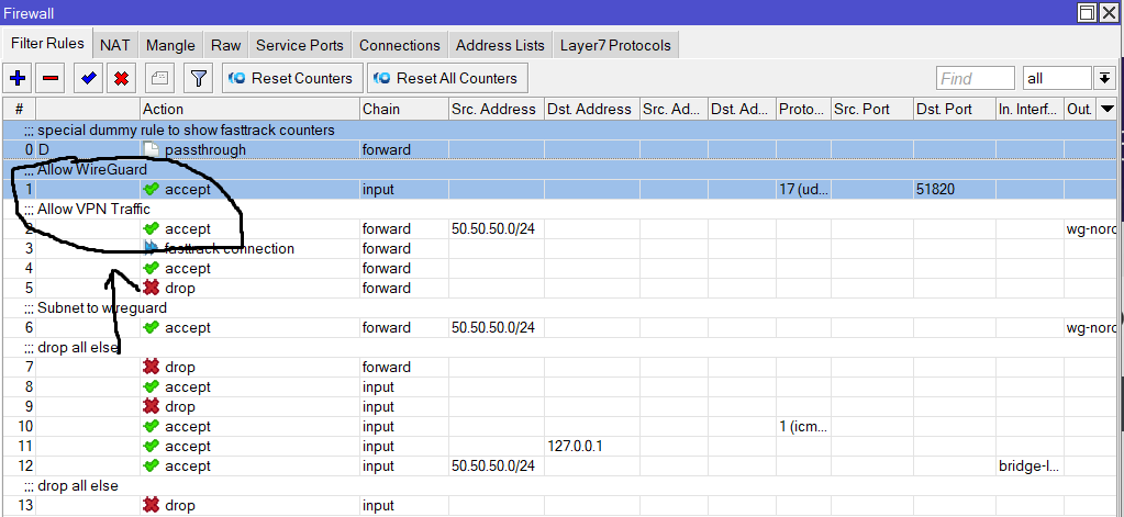

What do you mean? I copy paste them from ip firewall filter print command.
anynameyouwish.rsc (3.56 KB)
The config looks just fine to me, all good!!
So i removed the correct ones, those two
It would appear so, I read scripts better than diagrams LOL
thanks brother for all your help <3

Brother yesterday i had a power issue and had to force reset the router in order to make it work again. Now i paid that i didnt backed up the config we created. I followed the instructions, but as newbie that im, i want to ask when you ve time can you check the conf to tell me if its still fine? Main purpose is to redirect every single data through the vpn tunnel in order to avoid leaks, nothing else. Thanks in advance.
anynameyouwish.rsc (2.4 KB)
Things I would do…
  1. Change port settings ( dont favour all because its not true, in terms of perhaps a WAN port or LTE and definetly not your wireguard interface!!
    add bridge=bridge-lan interface=ether2
    add bridge=bridge-lan interface=ether3
    add bridge=bridge-lan interface=ether4
    add bridge=bridge-lan interface=ether5
    add bridge=bridge-lan interface=wlan1
    add bridge=bridge-lan interface=wlan2
    I assumed ether1 goes to WAN but if not then include
    add bridge=bridge-lan interface=ether1
  2. Use the DNS of Nordpvn in this setting
    add address=50.50.50.0/24 dns-server=(NORDVPN provided DNS) gateway=50.50.50.1
  3. Not sure why you avoided port here???
    SO make it clear’’

  1. Firewall rules are lacking…
    /ip firewall address-list
    add address=50.50.50.X list=AUTHORIZED comment=“admin PC wired”
    add address=50.50.50.Y list=AUTHORIZED comment=“admin laptop/ipad wifi”
    add address=50.50.50.Z list=AUTHORIZED comment=admin smartphone wifi"
    add action=accept chain=input connection-state=established,related,untracked
    add action=drop chain=input connection-state=invalid
    add action=accept chain=input dst-address=127.0.0.1
    add action=accept chain=input comment=“admin access” in-interface=bridge-lan src-address-list=AUTHORIZED
    add action=drop chain=input comment=“drop all else”
    add action=fasttrack-connection chain=forward connection-state=established,related
    add action=accept chain=forward connection-state=established,related,untracked
    add action=accept chain=forward comment=“WG traffic” in-interface=bridge-lan out-interface=wg1
    add action=drop chain=forward comment=“drop all else”

  1. For firewall, cause im gonna mess everything with the order, do you want me to delete everything in address-list and in filter, and add those you provided me?
