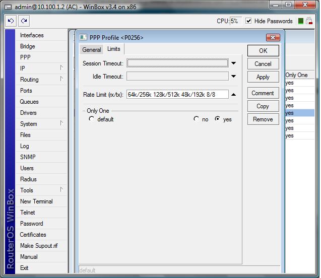

Can you post your pppoe profile configuration ???
its work for me in 3.4 and 2.9.50
56k/1024k 56k/1024M 56k/2048k 1 56k/1024k
Burst should work fine at 3.7 version.

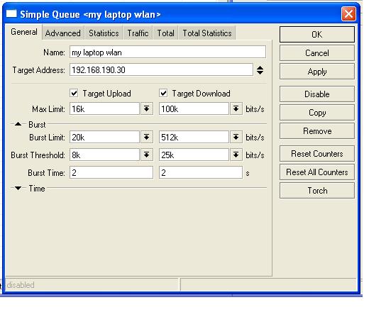

Hi ;
i need to use the bust to let the users reach reasonable speed during the first min of download or browsing to let them get what they need and then the server reduce the speed so they not affect other users .
i tried doing this many times but i didn’t succed , i am using 3.6 now .
here is a photo attached showing what i did today to test after i read this article .
is it correct ?
with best regards .
ahmedsaffar76, you are only bursting for 2seconds. That is too small a time to see any real boost. Increase the 2sec to 10sec or more to see it’s effect.
Hi ;
thanks for your reply .
this is just to check if the speeds are correct and each one on place .
i tried this before with 60 sec , as i remember it didn’t work .
so , here need to ask if i put time like 30 sec .
will it work correctly ?
with best regards .
Yes, burst should work with 30 seconds and 60 seconds too.
