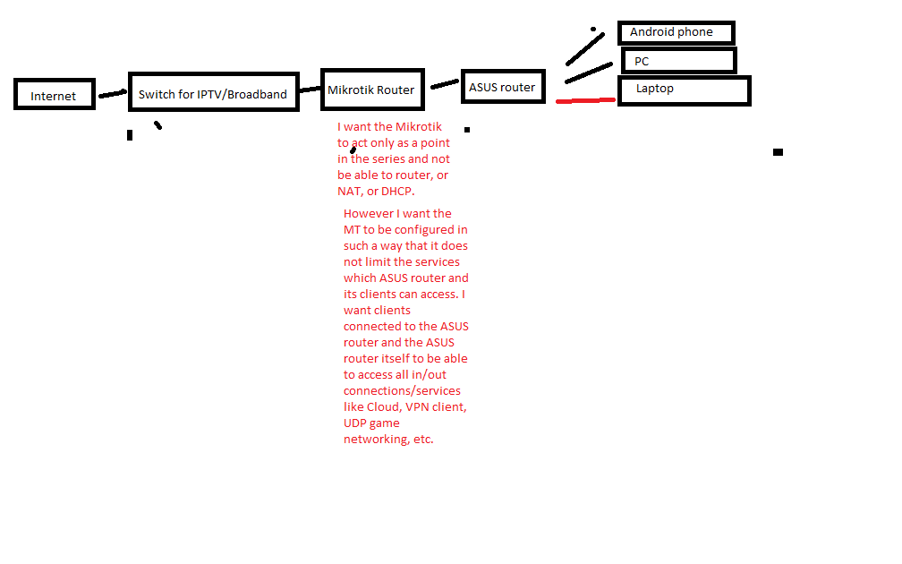

I need to use my MikroTik as primary router, to be connected to the WAN from the ISP and then a secondary router connected to the Mikrotik and all devices.
The topology should be as follows:
Internet → Modem/Switch → Mikrotik → my new ASUS router → All devices within my home.
Mikrotik is so customizable and has so many ways to be set up that I just don’t know how and actually I don’t know the name of this topology. The MT acts as what?
How should I configure the MT to act as nothing more than a point in the chain and pass-on all internet to the Asus?
Also, I am not sure about the primary (first) router which is connected to the internet ISP modem but the second router must definitely run DHCP and give IPs to the devices.
I want to use option 2 here: router behind router
https://learntomato.com/router-bridge-connect-two-routers-router-behind-router/
Topology drawing attached.
After reading a bit it is already clear to me that my MT should act as a bridge. How do I achieve that?

Disable the DHCP server in the MikroTik, then attach your links to the LAN ports (not port 1). Those are bridged so the MikroTik will behave as a switch.
What exactly is the point of the MikroTik in that diagram then? What you wrote in red text doesn’t make any sense. Just connect the ASUS to the internet if that’s what you want.
Or forget about the ASUS and use the MikroTik. Either way, you’ll accomplish what you wrote in red.

This is an exceptionally over-convoluted design for something that really should be very simple. What others are saying is your diagram doesn’t make sense, because you have one device too many which 1. adds complexity, 2. adds another point of failure and 3. and reduces the ability for you to do simple NAT’ing for any inbound traffic (with both as routers, and having one sitting behind the other, means double NAT which is just mega ugly).
Realistically, you need EITHER the ASUS OR the MT and have it act as a router for Internet traffic (or bridge/router). The only reason you may want both devices, is if you were wanting to have say one router dedicated to Internet traffic and one router doing routing to some other private network - but they’d have to hang off the same bridge group / be on the same subnet, say 192.168.1.254 as your Internet gateway, and 192.168.1.253 as your private WAN gateway, then PC’s would have their default route set to the Internet gateway, and that router has a route on it that says "to get to remote subnet 172.16.1.0/24, then hop to 192.168.1.253)
  • A bridge operates at layer 2 (does NOT do routing, never will, ever)
  • A router operates at layer 3 (does routing between networks)
  • The Internet facing device (whether it be the ASUS or MT) must be a router (and NAT your private network out to the Internet)
  • If the Internet facing device IS a bridge, then there must be another device behind it that does the routing to the Internet (then there are many other factors you need to consider, such as your Internet connection type, encapsulation etc)
Now you have to ask yourself, and as others have said - WHY would you need both routers? Having both is possible - but it is totally unnecessary UNLESS that internal router routes to some other location, in which case it should really be connected to the bridge.
So… (hopefully this comes out right… EDIT: nope it didn’t - the bottom line with the ^ points to the Bridge…)
Internet <----> Router <-----> Bridge <----> PC’s
|_____> Router <------> { WAN } <—> Remote Router <----> Remote LAN
Both MT and most likely the ASUS can be a bridge and router, depending on the number of LAN ports you need, then that maybe one reason why you’d want one over the other (assuming both had similar features and functionality)
If you can list your requirements, then we can help you with the best design. You mention “ExpressVPN” which makes me assume you want some sort of site-to-site or client VPN tunnel established?
