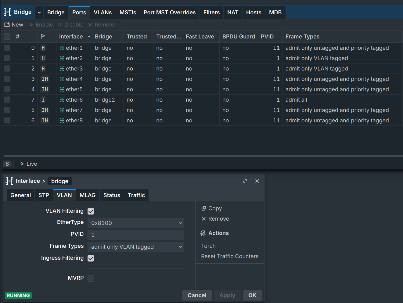

The problem is that when I configure the trunks this way:
interface bridge port
set [find interface=ether2] frame-types=admit-only-vlan-taggedset [find interface=ether3] frame-types=admit-only-vlan-tagged
The Wi-Fi isn't working; it currently works in this mode, but it's not secure. "admit all"

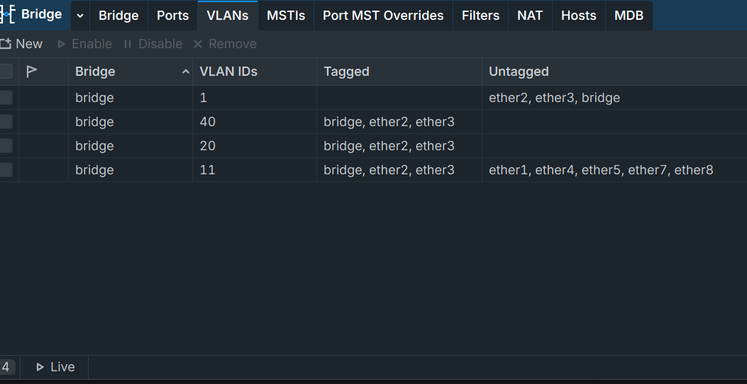

vlans:
abc@MikroTik] /interface/bridge/vlan> print detail
Flags: Y - MANAGED; X - DISABLED, D - DYNAMIC
 0    bridge=bridge vlan-ids=11 tagged=bridge,ether2,ether3 untagged=ether1,ether4,ether5,ether7,ether8 mvrp-forbidden="" current-tagged=bridge,ether2,ether3 current-untagged=ether1
 1    bridge=bridge vlan-ids=20 tagged=bridge,ether2,ether3 untagged="" mvrp-forbidden="" current-tagged=bridge,ether2,ether3 current-untagged=""
 2    bridge=bridge vlan-ids=40 tagged=bridge,ether2,ether3 untagged="" mvrp-forbidden="" current-tagged=bridge,ether2,ether3 current-untagged=""
 3    bridge=bridge vlan-ids=1 tagged="" untagged=ether2,ether3,bridge mvrp-forbidden="" current-tagged="" current-untagged=bridge,ether2,ether3

If you want a bridge port to be trunk for several vlans, it's pvid should be set to 1.

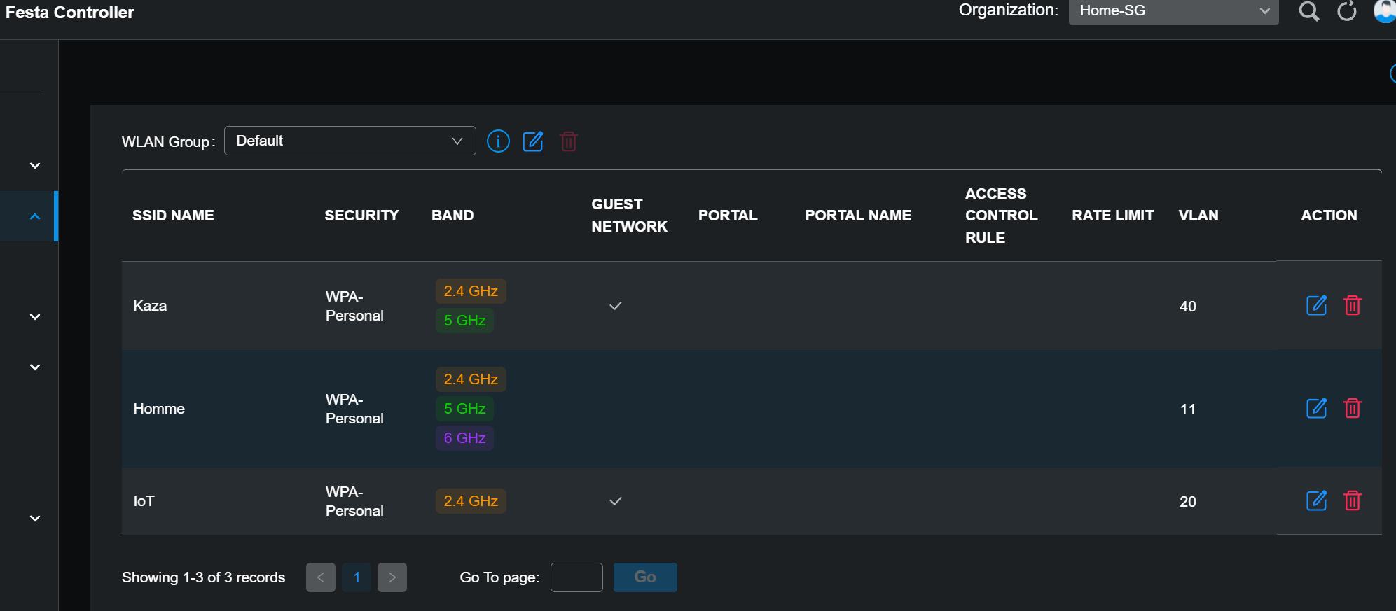

Is that Festa 65 not an Festa F65, which doesn't have 6 Ghz band, but you still configured one SSID for it?
Not true. PVID takes care of untagged frames (on UTP side of port) and can be anything. However, as soon as one sets frame-types=admit-only-vlan-tagged, untagged frames on ingress are dropped and PVID setting becomes irrelevant.

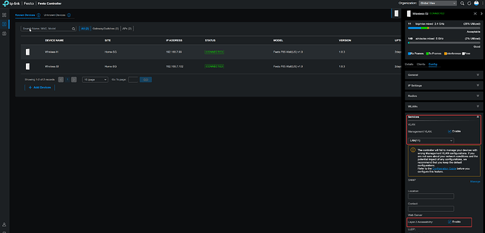

@z1ckb0y : does your TPlink AP really work with everything tagged? Many brands (e.g. Ubiquity) require management "VLAN" to be untagged - they often call it "native VLAN" which actually means "untagged on wire side with PVID set" (and PVID is often hardcoded to 1 ... hence recommendation not to use VID 1 for tagged VLANs).
Very good, learned something new today.
Fortunately, the TP-Link does have the option to configure the management VLANs; the configuration ended up like this:
