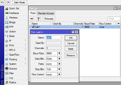

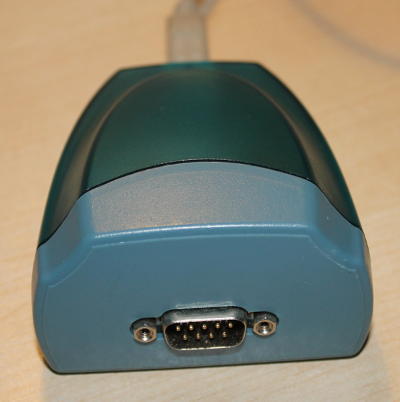

Why 4 serial ports? i don’t think that this device is compatible
This one is compatible with routerboards
