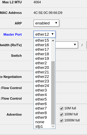

tirkitneth, yep, but how to deal with master-port ? how to tell other ports to use the trunk as the master-port ? Because for now when I choose the master port I see only ether ports in that list
If you switch packets from between ether1 and trunk1=ether2+ether3, then you can set master-port=ether1 on ether2 and ether3.
If you wish to route packets on a trunk, then I don’t know. I don’t plan to use a CRS as a router.
tirkitneth, I also don’t plan to use CRS as the router, the problem is I want to create a trunk between a CRS and a CCR
See the link posted earlier: http://wiki.mikrotik.com/wiki/Manual:CRS_examples#Trunking
