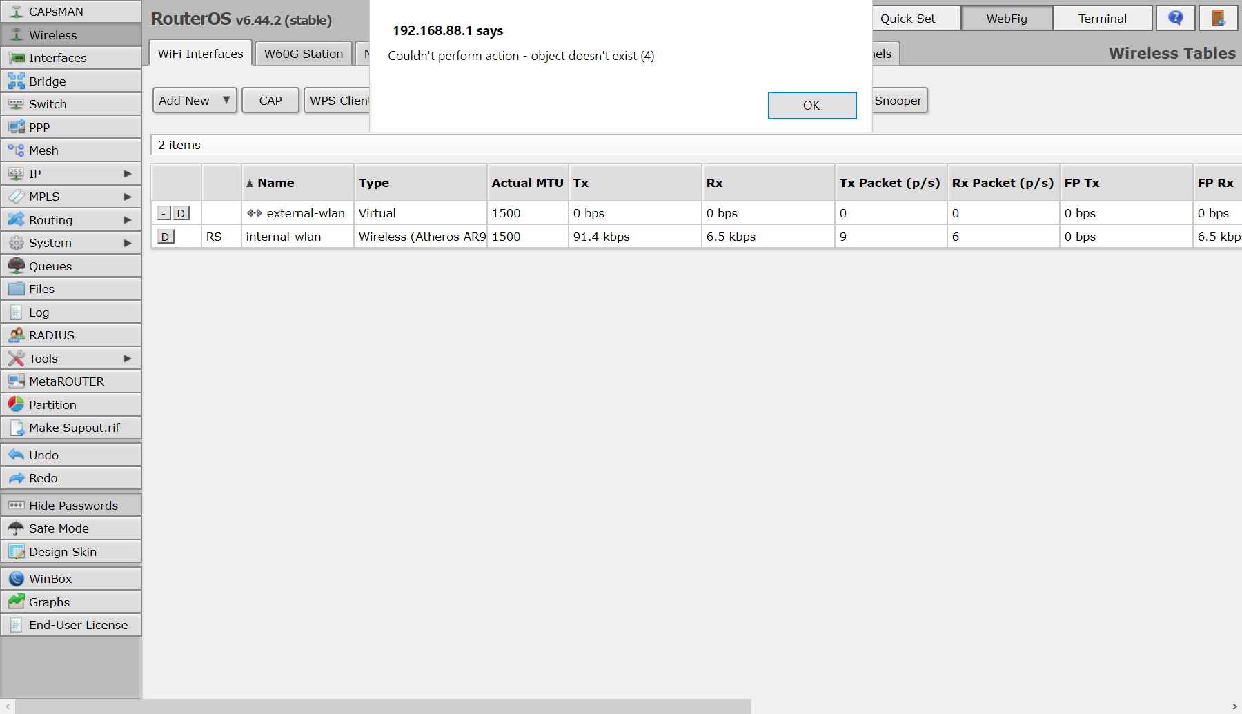

Thanks for your reply.
When I do that I get this error (screenshot attached):
Couldn't perform action - object doesn't exist (4)
I believe this is because the external-wlan device is a virtual device. I’m using the mAP-2n as a travel router so it connects to hotel wifi network (external-wlan) and provides local wifi to my devices (internal-wlan). internal-wlan is an ‘ap bridge’ and external-wlan is a ‘station’.
