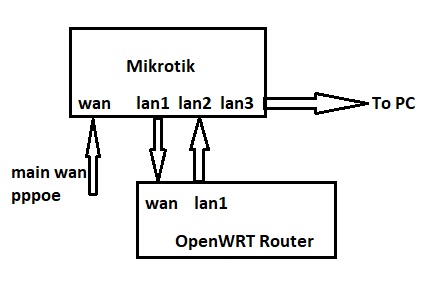

scheme
OpenWRT processes only traffic to certain sites (IP).
Everything works separately. When routing I get a ā€œringā€. Since Mikrotik routes traffic in a circle
That is, if I use the OpenWRT gateway in this connection on the computer (removing the routes in Mikrotik), everything works. But if I add routes to Mikrotik, the traffic does not pass

So It Is what rextended posted :
If we can abstract for a moment from the fact that having more than one bridge on a single Mikrotik device Is usually not advised, you could have:
bridgeWAN with ether1 and ether2 in it
and
bridgeLAN with ether3-ether_n_ in It
It Is a good idea (particularly when fiddling with bridges) to keep one interface out of any bridge to have a "safe" management port to access the router and it's configuration.
But then, what Is the plan?
Which device (the Mikrotik OR the Openwrt one) will be (optionally) the DHCP server and the gateway for the devices on the (single) LAN?
The main gateway is Mikrotik (DHCP). It receives internet via VLAN and PPP.
I don’t know how to combine 2 ports into a bridge, since PPPoE doesn’t allow this. You can’t add this interface to the bridge.
I can install OpenWRT at the beginning. But there is a problem with IPTV. Mikrotik works better with multicast
the question is, can mark and prerouting-postrouting solve the problem? transparent proxy?
google.com → mikortik → wan
amazon → mikrotik → OpenWRT → Mikrotik - wan
Mikrotik routing allows you to send traffic to different internal gateways. Mikrotik’s internal gateway1 is a PPPoE connection. And the second gateway is an IP OpenWRT
We need Mikrotik internal setup to understand what is wanted here.
Ethernet ports in mikrotik as such have no special meaning as WAN or LAN , unless defined by their internal setup
So we have Mikrotik,
  • PPPoE from internet, is connected via ethernet port labeled as WAN
  • That Mikrotik WAN ethernet port is not a port on the bridge (then create PPPoE with that ethernet WAN interface as master interface)
  • we name ithat bridge now WAN bridge
  • WAN bridge here now is with ports set : PPPoE and Mikrotik ethernet port labeled as LAN1 in your diagram
WAN bridge
– port PPPoE
– port LAN1
  • BUT ethernet WAN connection itself may be needed also on the bridge as alternative Internet connection
    (only then add ethernet WAN as port on the bridge and create the PPPoE interface with the bridge as master interface !)
    (either the PPPoE interface or the ethernet WAN interface can be defined as port on the WAN bridge.
    (Mikrotik does not need it to be a port on the bridge to use it, but that interface is needed as port on the bridge to forward it unprocessed to the OpenWRT)
    (Make the not-as-port interface member of the WAN interface list, as needed)
  • That WAN bridge is made member of the default WAN ā€˜interface list’ , not the LAN interface list
    (because the default firewall rules are defined for the WAN interface list (eg Masquerade, blocking input and not forwarding traffic that is not DSTNAT (outgoing connection))
  • That WAN bridge has a DHCP client if needed as PPPoE would need it.
Remark general rule: (All L3 functions like DHCP server, DHCP client, IP addresses, PPPoE, and also interface list membership … are defined on a bridge, and not on the ports of a bridge)
(A PPPoe client interface can be created with the bridge as master interface, but not with an ethernet interface, if it is set as port of a bridge, as the PPPoE master interface)
  • The OpenWRT WAN port has a DHCP client if needed (or set the addresses and fields manually)
The PPPoE link must allow for 2 IP addresses , as both the Mikrotik and the OpenWRT have a WAN IP address
NAT (Masquerade) could reduce that requirement to only 1 IP address. But NAT is what you wanted to avoid.
Both the Mikrotik and the OpenWRT could have their own PPPoE client (and corresponding IP address) if the ethernet WAN is forwarded via the WAN bridge.
  • extra bridge, the LAN bridge (add that 2nd bridge)
  • LAN bridge is made member of the default LAN ā€˜interface list’ to use the default firewall rules (eg which allow input and forward traffic)
LAN bridge
– port LAN2
– port LAN3
  • Mikrotik ethernet ports labeled LAN2 and LAN3 are ports on the LAN bridge
  • LAN bridge has a DHCP server set up, to service the Mikrotik LAN clients
  • avoid having 2 DHCP servers on the same Layer2 LAN (so stop either the mikrotik DHCP server or stop the OpenWRT DHCP server)
    OpenWRT lan1 and Mikrotik lan2 and Mikrotik lan3 and Mikrotik LAN-bridge are all on the same Layer2 network
Yes. Thanks. So it works. But it requires 2 pppoe.
The provider blocks several connections. Every other time, but it works if I clone the mac
