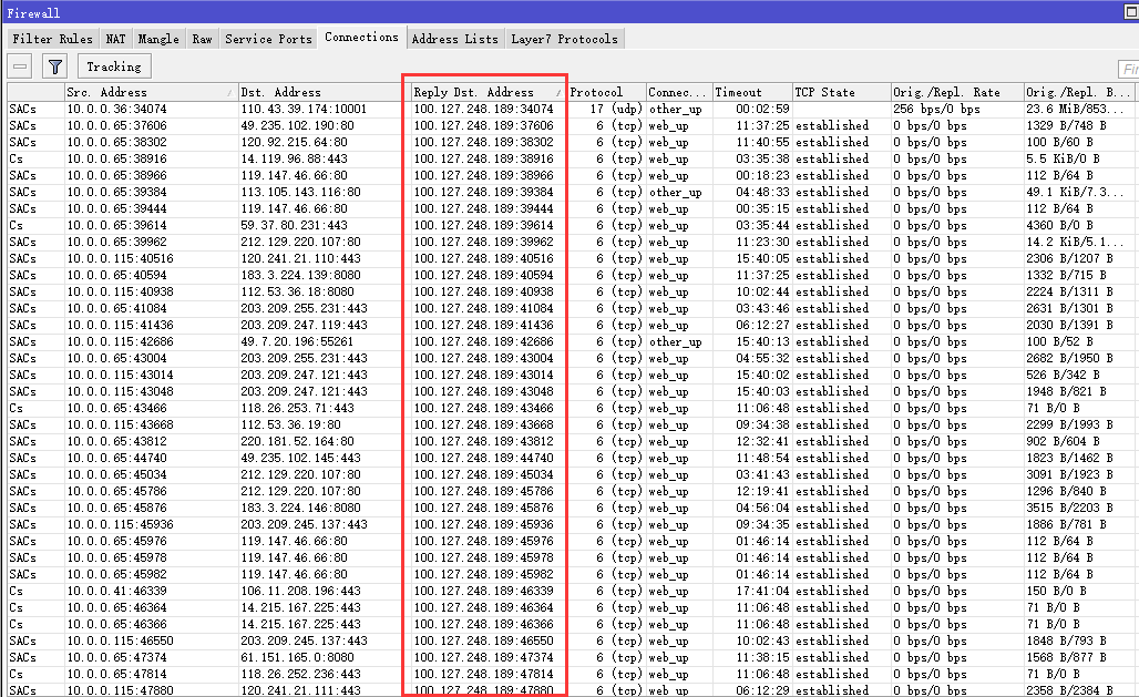

As in the question, I need to use a script to delete all the connections of the specified ip, but the port number of the ip is different, the script does not know how to write the most efficient.
Probably all your connections have that. It is your own external IP used to translate the internal address (the 1st column) to the internet address you have.
(100.127.248.189 is another “internal IP”, which will again be translated further down the path by your ISP)
After the pppoe client is disconnected and reconnected, the ip will change, and there will be many old connections in the connection list, which will not disappear for a long time.

/ip firewall connection remove [find where reply-dst-address~“1.2.3.4”]

This will also remove connections for addresses 11.2.3.4 and 1.2.3.44… Better match beginning and end of the address when using regular expressions:
/ip firewall connection remove [ find where reply-dst-address~"^1.2.3.4:" ]
